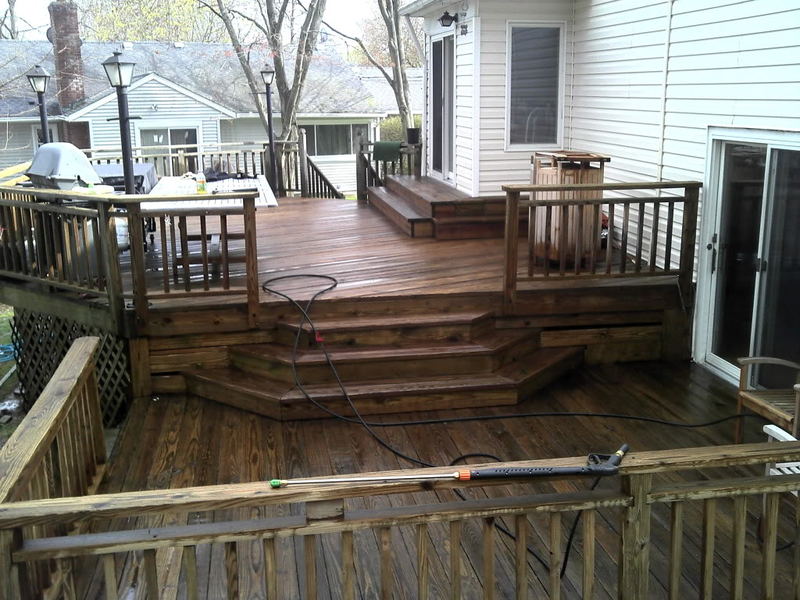

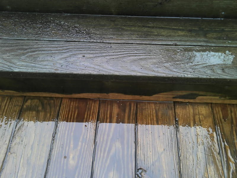

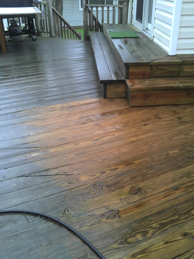

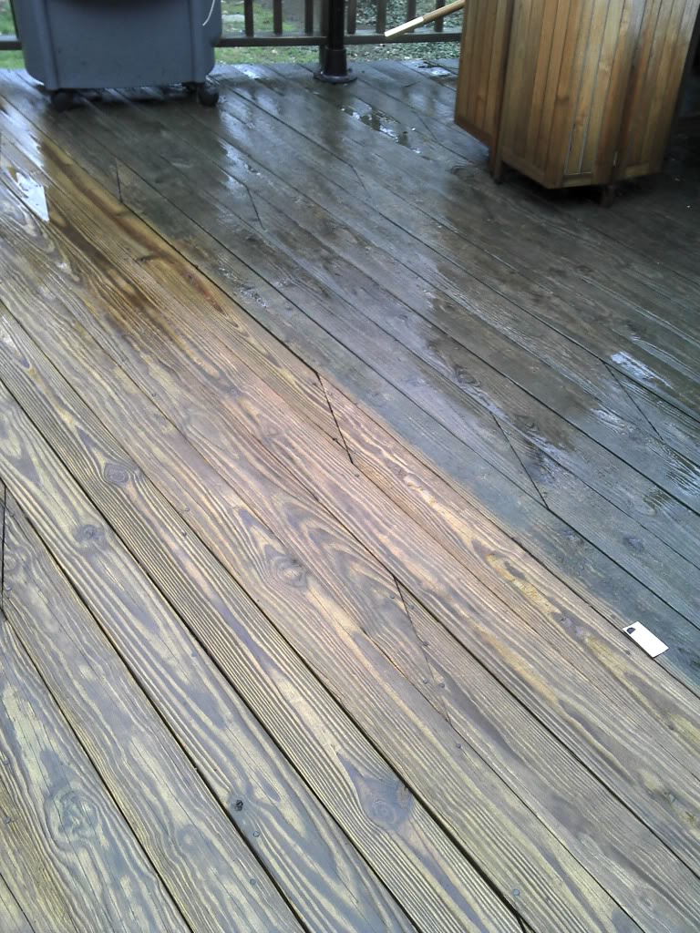

Used to do it. 2 part chem system that would even take gray weathered (not just dirty) wood back to looking like new pine.
You prewet, apply the first chem, pressure wash it off. Then come back with a second chem that ph corrects, about 2 minutes after it hits it starts changing color.
Actually pretty amazed at how well it worked.
