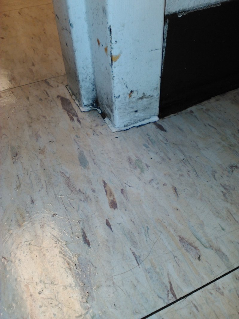

Stain removal is extensive mainly in the break room however the buildup of dirt around all the baseboard and corners is thick. Just to let you know we did their other building and had a hard time getting the floor around the baseboard to look nice and clean. It appears whomever did the floors did not bother to strip it down to the bare essentials before applying new wax. I applied the baseboard stripper (aerosol) directly to the baseboard and stripper to the floor around the baseboard/corners, let set for a few and then I used a doodle bug and although it looked way better it still did not look as good as I would have liked it to so any suggestions would be appreciated. Oh and I did get on hands and knees to use the razor knife but that really didn't do much good either.

What color is the vct? Off white with some specs of Brown. I ask because I want to know if it is colored(anything but white) if the area of the floor turned white or not. In other words did anything happen chemically and or to try and identify what is on the floor. The floor stripper worked well on the floor, it was the baseboards and corners we had difficulty with. I used the aerosol and when that didn't work I applied the stripper from the jug to the areas and that didn't even do the trick. Apparently they used the same product because we stripped/waxed the floors in the other building this weekend and it was just as bad and primarily around the baseboards and corners.
Did you attempt to strip the same areas more than once? yes
Or did you just throw stripper and hit it over and over with poor success? Yes
Sometimes neglected floors need to be stripped more than once to get them back to a clean and wax ready state.
Do you have pictures? Yes and I will upload them.

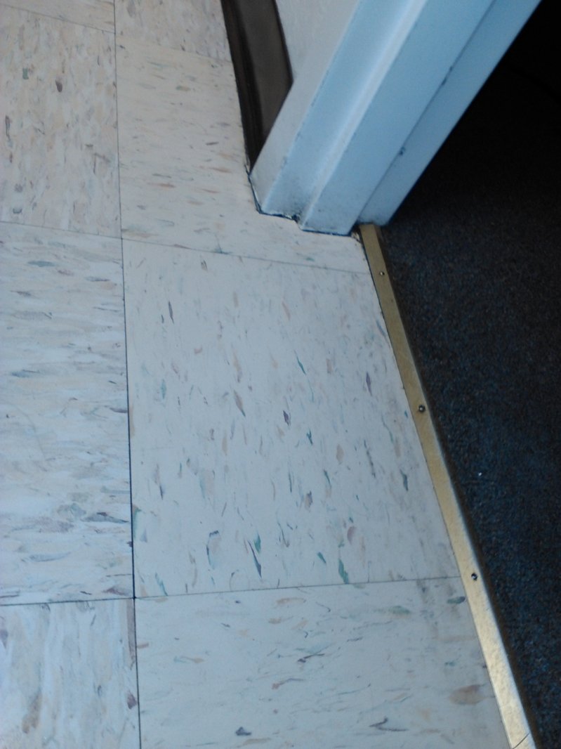

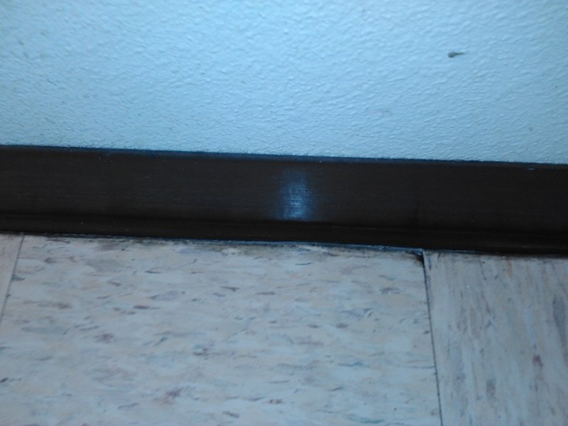

That is bad and will need to be stripped multiple times to correct many years of subpar workmanship and or lack of maintanence.
All that trash and hair in the wax is very unprofessional.

1st, odds are you will never get it 100% right the 1st time, there are jobs that i have done 4-5 times until things look right.. there is a chemical bonding that goes on that makes it so the finish wont come off the floors as easy around the edges...part of life
2nd, i have never been a huge baseboard cleaner unless they are paying for it...1 it takes a helluva long time, 2 you can start making that baseboard bleed out (it is a rubber/plastic product and the chems we use break down those things) 3 you can make them look worse, and thus the customer unhappy....4 i am a floor guy not a wall/coving guy...thats just me
