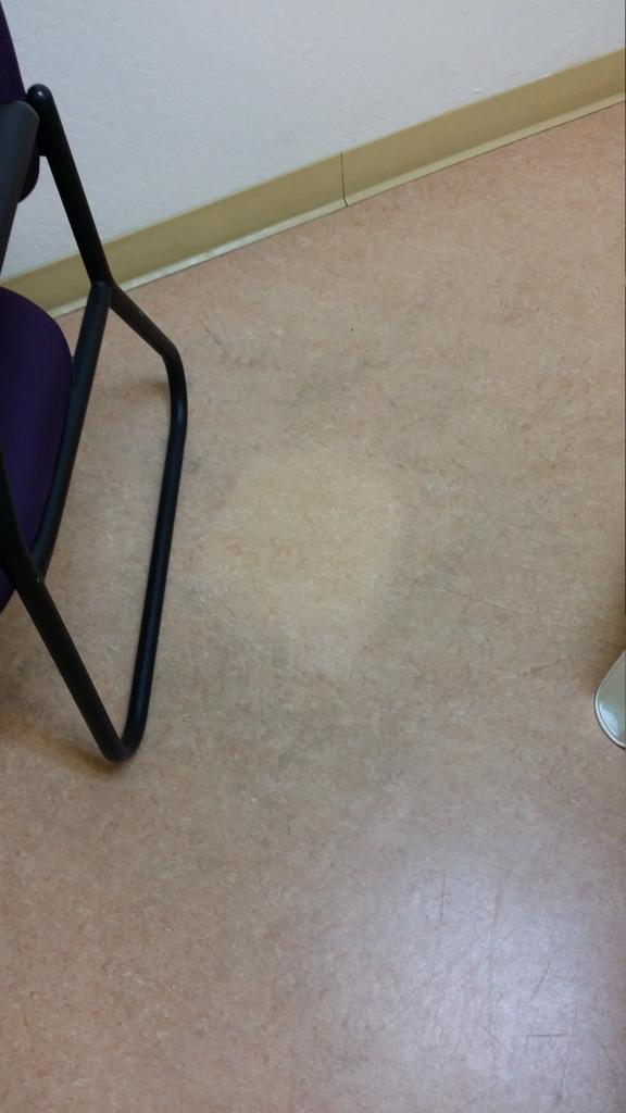

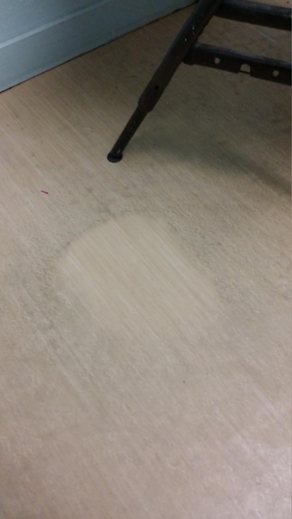

Customer does not want this VCT refinished, just stripped..
115,940
They don't want to have to deal with the buffing, stripping and resealing all the time in 20 small exam rooms.
I tested some areas and the funk came right off with a 3M scub pad and some Devastatro stripper.
Looks like just Fabuloso build up
How will this type of Vinyl perform with out a top coat of any kind?
assumingan get them to use a micro flat mop and neutral cleaner

It won't. It'll get scratched, scuffed and dirt imbedded that won't come out with a witch doctor. Any guess how many mil the finish (clear) vinyl is?

I have one Friday, and I haven't done one in like 15 years.. Kind of anxious about it.. I did a test area and it cleaned up great, but it's out of my comfort zone..
