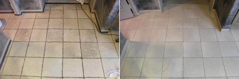

Most of the time, when someone requests to have their marble clean, it's not actually dirty. Most marbles are pretty dense and have a high surface tension, and won't really soil. Except Bottocino. This bastard marble will get filthy and it's a pain to refinish. It is often confused with Crema Marfil, which is very easy to work on and doesn't really soil much. They look very similar and in some cases can look the same, but they do not polish the same way. They are both Compact Limestones from Italy.

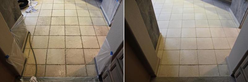

I went to this house to refinish their bathroom counter. When I mention the floor, the lady said "Oh it's dirty? I didn't know I had to clean it" Mother of God.
If I can do this without a truck mount, surely you guys can do it faster.

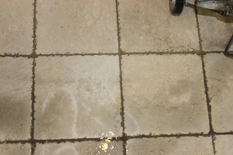

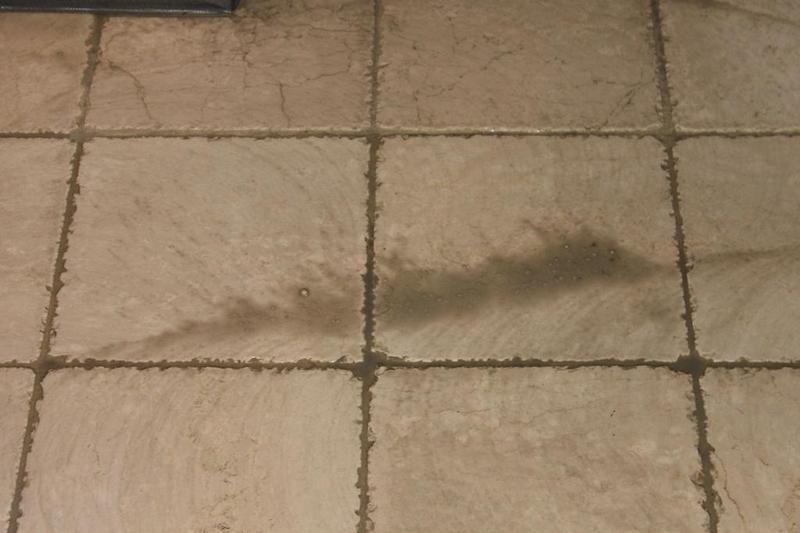

Because it was a tumbled finish, I didn't need to worry about etching or scratching. A tumbled finish is just marble tile that's put in a tumbler. It has a matte finish, with chiseled edges and some minor pitting in the surface. They just basically beat the hell out of it and sell it.
I used a 180 grit Malish brush, our honing powder and some Alkaline cleaner. I think I used Aquamix Heavy Duty Tile and Grout Cleaner. I did this probably 4 years ago or more.
Put the cleaner down and let it dwell to get the dirt. Throw the honing powder everywhere right before you scrub.
The cleaner gets the dirt, the 180 grit brush scrapes the grout and tile thoroughly, but not enough to damage anything, and the honing powder ensures a consistent, swirl free finish.
