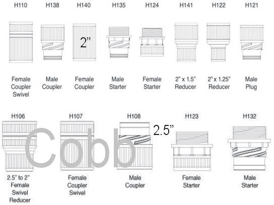

Larry Cobb
5,795
Larry Cobb
The latest Cuff Lynx have molded in rubber bands for sealing.
They also have 2.5" sizes & 2.5" to 2" reducing cuffs now.
The best part is . . .
they are priced close to the cost of vinyl cuffs and connecting barbs (and shorter in length).
So what is not to like . . .
