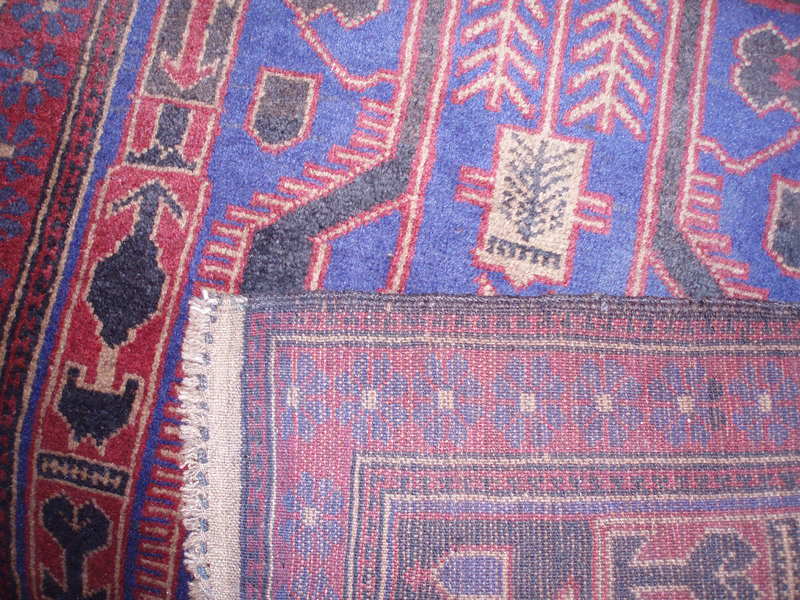

I talked to him a bit and took some picture to quiz Randy with.
I told him about the Board and the rug ID thread. He showed me a rug he thought would stump the group here.
Well Randy?
How about these?
To be fair I did hear him tell a couple that the rug they were looking at was a wool silk blend.
I sure didn't see any Silk so he may just be full of it.

It’s a dumping ground for all crappy rugs that are unsalable you’re going to see more of this in the future
1. Shiraz from Iran
2. Baluchi from Afghanistan
3. Appears to be Indo Persian or Paki the ends has been reworked making it harder to ID
4. Pakistan chobi
5. Sino Persian ..tabriz design
6. Indo copy of armenian Kazak or Turkish rug
How did i do which one is the "stumper" ?

Rhyde so these rugs are crappy but they came from iran and countries that make good and expensive rugs how do you tell theyre crappy? how did you know the ends were reworked on the one rug?
Is there any good books to help with ID and other rug help? thanks for sharing knowledge

These are the type of rugs that probably won't be around in 50 years, but most rugs buyers today don't care about buying something for their grandkids. Their grandkids probably won't want it anyway. This type of rug is the kind that can have the fringes cut off and glued under because they're just commodities.
Rug cleaners that see a lot of investment quality rugs or expensive and well made rugs often fall into the mode of calling everything else junk. Something we have to guard against.

LOL… I don’t mean to offend anyone. In decorative market terms these rugs are junk or duds some of these will wear just fine and last a long time However, esthetics drive the rug market not durability or even quality. There are plenty of poor quality expensive rugs out there so don’t think more money equals better rugs because that isn’t always the case. Some of this stuff has become dated meaning the colors or designs are not appealing to the current decretive market, some wasn’t good from the start and some have condition issues making them unsalable at a profit in a legitimate rug stores. Which is why these rugs end up in a secondary discount market like Costco, EBay, IKEA and 80% -90% off going out of business sales.. Anything is salable at the right price/ marketing.
“How do you tell they’re crappy?” Cleaning, selling new and antique rugs is the answer here is some books I recommend..to start
