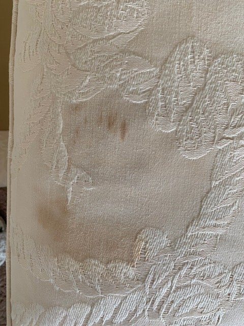

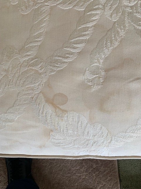

coffee on sofa
sassyotto
Jun 7, 2013
1,327
Paul
two sofas. tons of coffee spills.
Any suggestions?
28,265
Reactions: hogjowl
28,265
applied Stain 1 prior to cleaning, 2 hours later no change.
