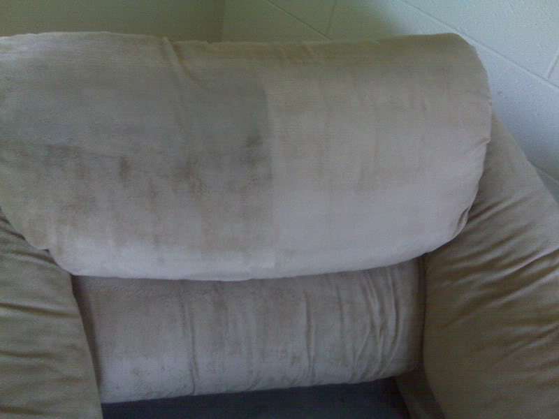

I have one local company who refers their microfiber cleaning to me. I don't know why. I have never had a problem with them. I did 3 this week and all came out great. Lower the temp and psi and your good to go.

You gotta love Kriby vacuum sales people. We bailed there butts out again. Same type of people will let kriby in to demo then demand new furniture. We go in behind them and clean up after them.
Customer said it looked Brand New before kirby touched it. Then it was all messed up after they did there demo. She had 2 small kids and when we got there, one of the little girls spilt supposedly water on the cushions. I wanted to tell her so bad not to insult my intelligence.
We use Ultra Dry sprayed on and scrub it in, then fresh propane heated water rinse it. Never did have a problem in over 13yrs using that process.
