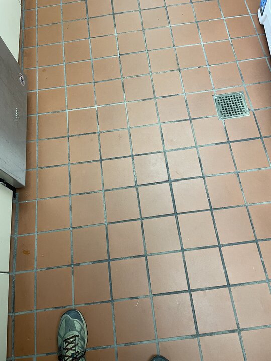

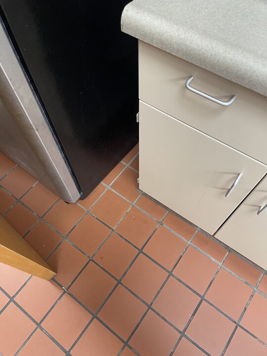

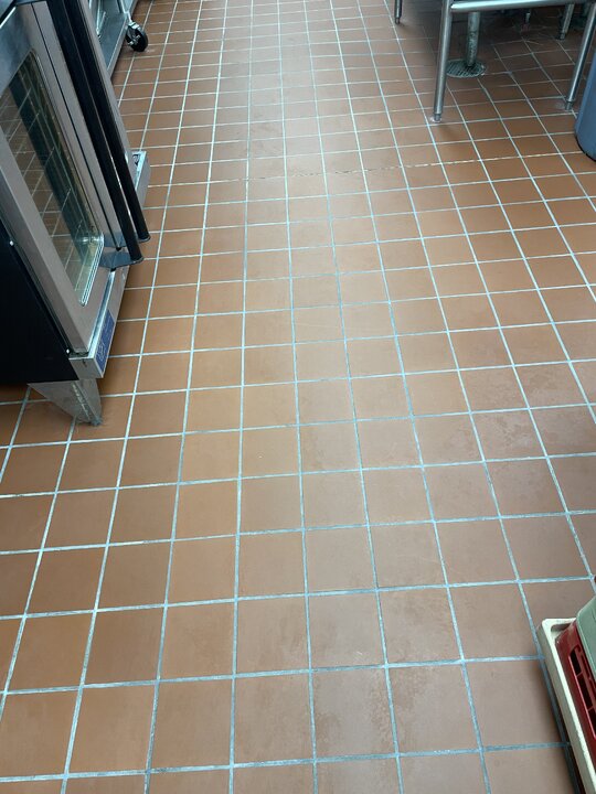

Several years ago I tried to clean a floor just like this at another church with dismal results. Now I have this floor another church is wanting me to clean. I’m asking not for tool advice but I’m looking for chemical advice on what to use.

I really don’t know how much of the black soil in the grout lines is grease or if it’s just 30 years of mopping. I ordered a case of Saiger’s Tsunami and Vengeance.
