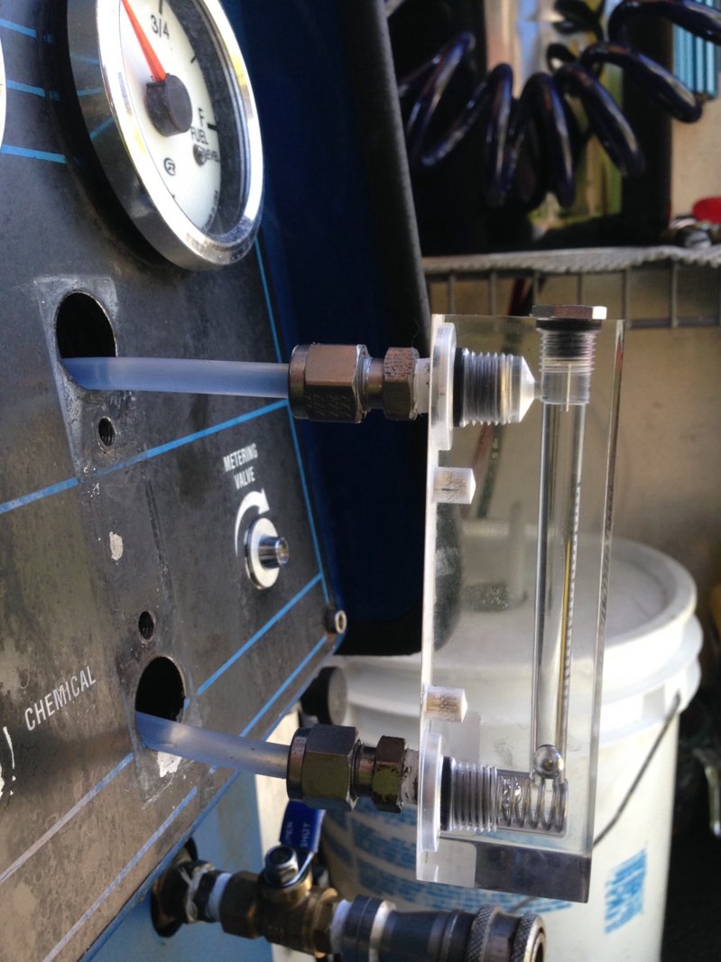

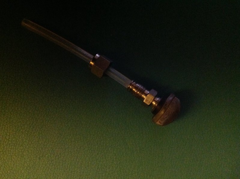

I replaced everything that touches chemicals with stainless fittings. I used fitting made by swagelok that are designed for the valves we are already using. They make a rigid plastic line that locks in. Simplest thing I've ever used. It uses a stainless feral around the plastic pipe when tightened locks it permanently. I don't remember how long ago I put them on my last machine but I never had a single leak or problem. you place a feral nut on the plastic , then push the plastic in to the nut and snug up. Tighten with a wrench 3/4 turn and your done. This is the fitting from my stock tank. It sat in concentrate on my last machine for years with no wear.
