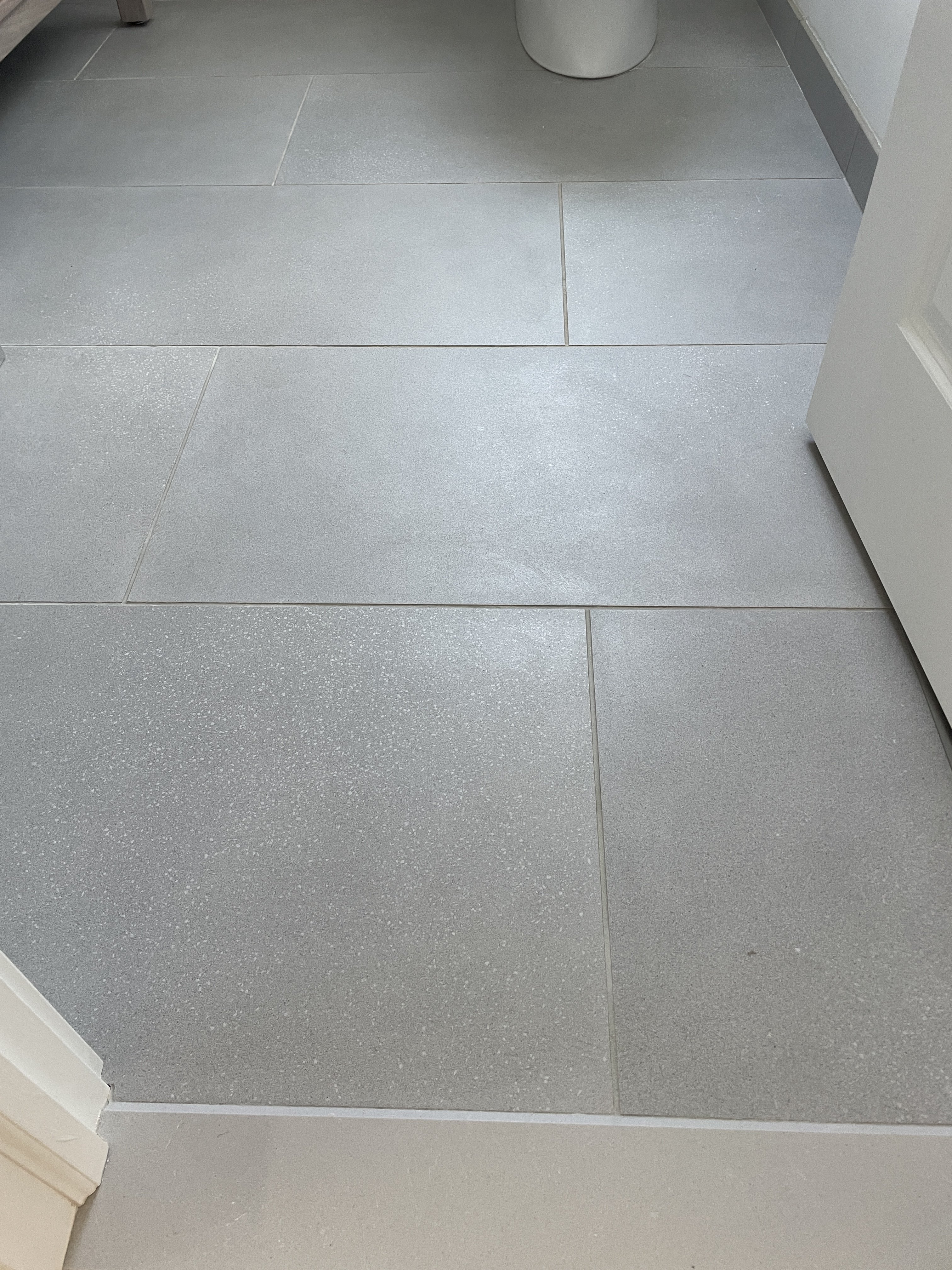

I passed on this yesterday. This is one is one Month old. Porcelain. Those grout lines look like trouble. 3 small bathrooms I figured I would wait till after the multi surface course to have a confident plan of attack.
Lady was cool with late October.
This pic is one month old. Does grout need to cure still?
This next pic is one I passed on cleaning. It is a year old. You may be able to scroll in and see the marks that spooked me.
115,889
Likely just soiling from improper mopping but unsanded grout can sometimes end up splotchy like that from a variety of reasons.
