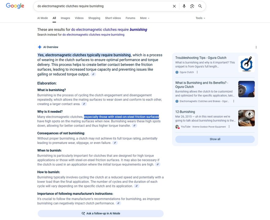

in case Dwayne needs a google screenshot since I know he loves them
AI/google is not a substitute for critical thinking and proper research especially if you don't know what questions to ask
