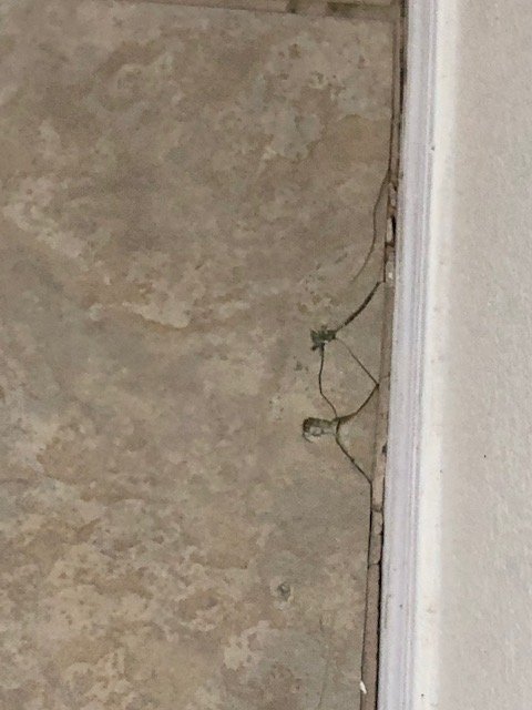

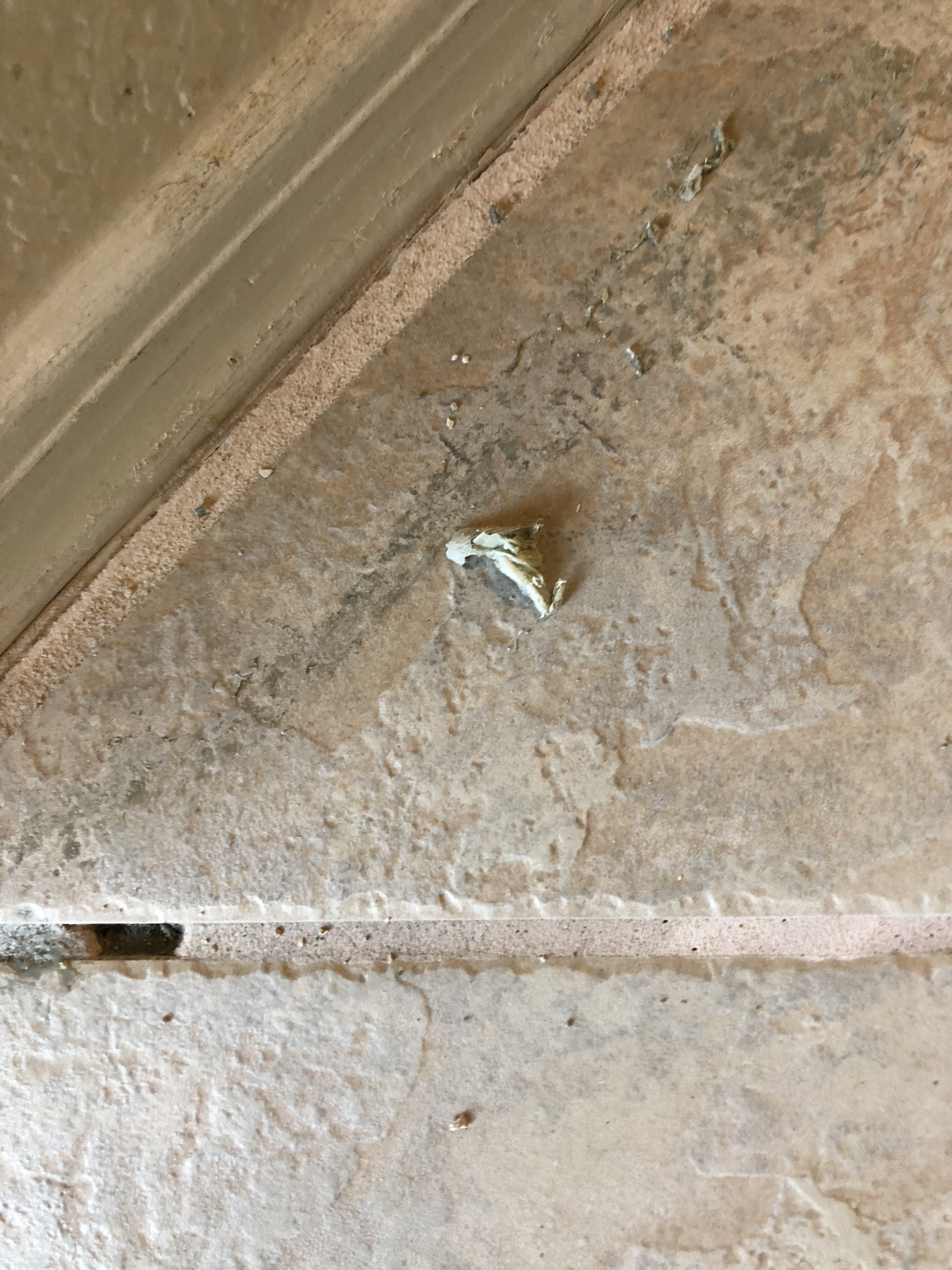

Tenants son put everything in moving truck and is paying for every day.
They agreed to $1,300 for 707 sft.
I don't know until after if -
I will be new guy.
If I bid correctly.
If I will be glad or learn a lesson or both.

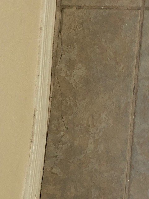

They are in a hurry, so they didn't want to wait for me to caulk baseboards.
They signed off on a waiver for swelling baseboards.
Instead of using Turboforce, I'll be using Trinity on tile to avoid over-wetting the floor.
They say they want to talk about becoming their new cleaner.
Hopefully it works for all parties.

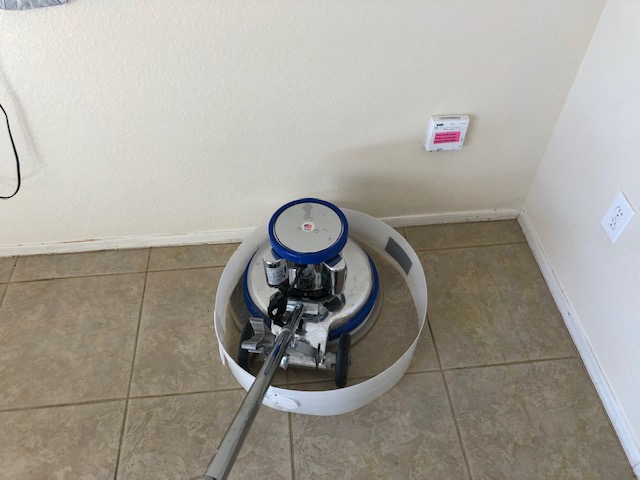

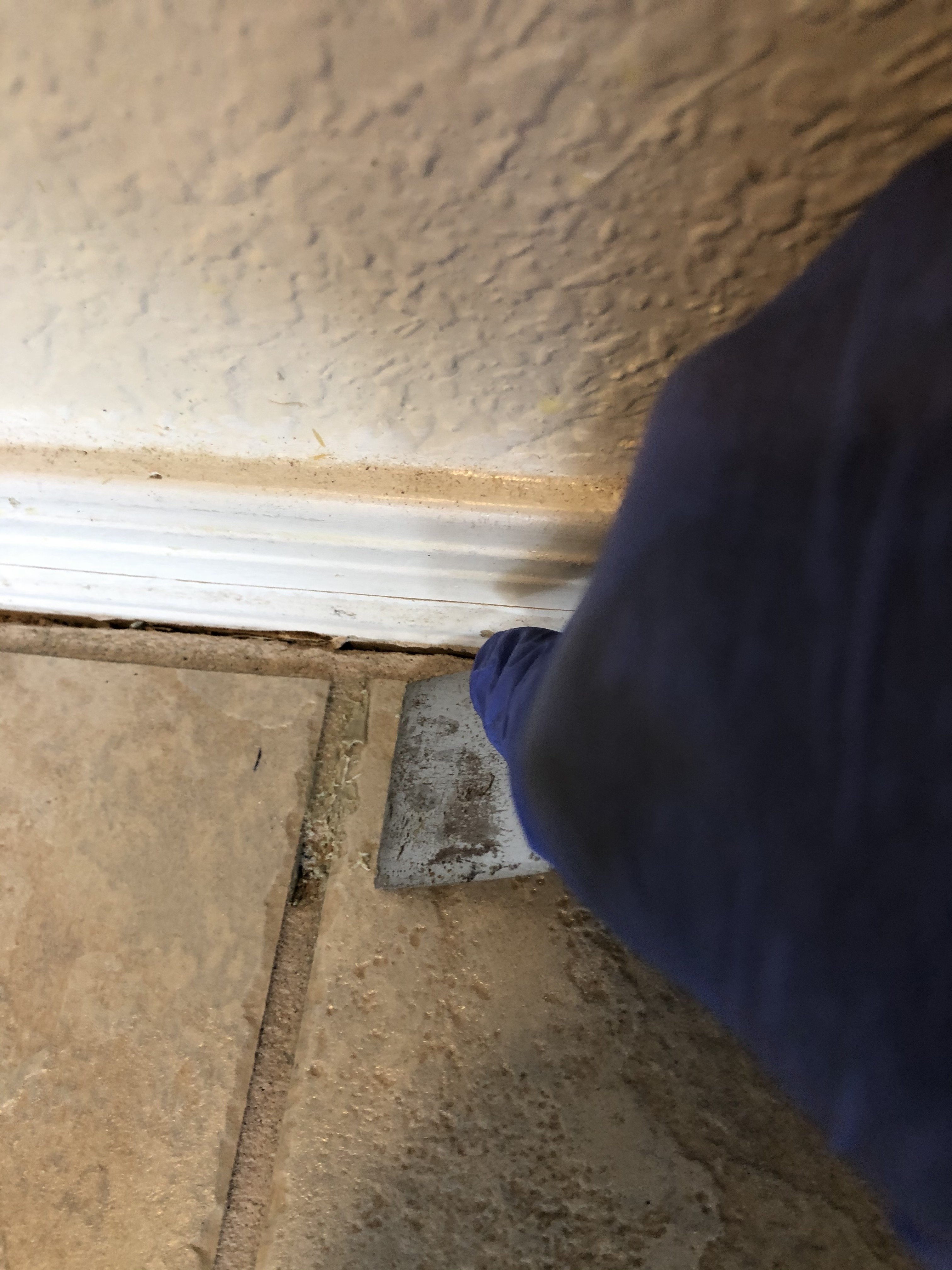

The textured tile makes a razor only one step.
I used Sentinel 707 among others, but it worked best w/o removing color seal off of grout.
I spray floor, let wait 10-15 minutes, because in Phoenix it dries up too quick to wait longer.
I cover with plastic drop cloth so it can sit.
Then I have a 50 lb. weighted plate for my 175 and a ring to stop splatter.
I'll use that with fiber pads underneath plate to scrub.
Vacuum up w/shop vac.
Scrub edges w/ doodlebug.
Follow w/Trinity tile brush and Simix to clean.
Neutralize w/StoneTech Stone & Tile Cleaner.
Follow w/fiber pad to shine, if needed.

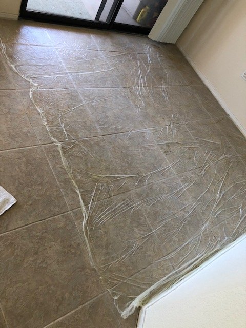

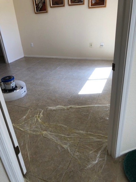

I sprayed Sentinel 707 or 747 (the one the Home Depot had) and covered with plastic so it wouldn't dry until I got to the section.
The plastic allowed me to take time I needed in one section before rushing to another.

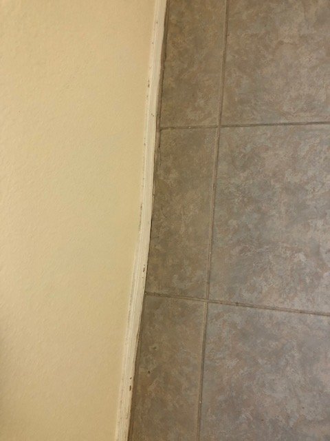

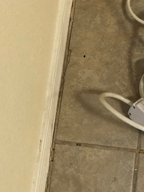

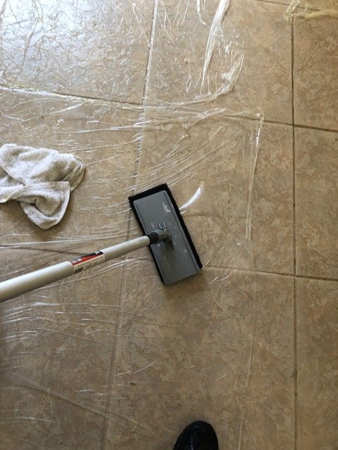

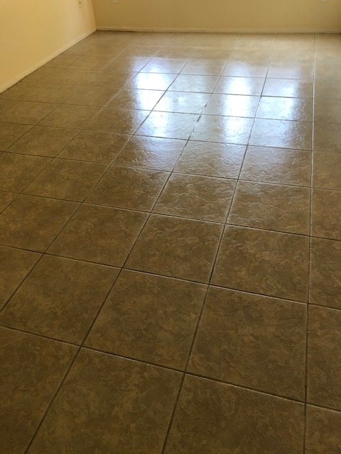

The remover was to be removed with a good rinse.
I ended up using old soaked glad pads, followed by a dry one to absorb.
Then I was able to do the Simix, Stone Tech method to clean.
Turboforce would have been so much easier.
But the baseboards needing caulked and the damage from removing carpet tack strips took that option off the board.

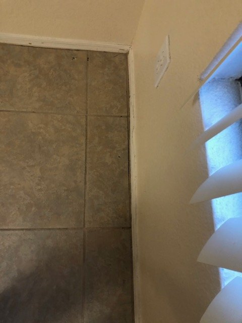

Mike told me to get a 175 when I first started.
I'm grateful for that advice. I got a 50lb. drive plate to polish with.
Both made this job easier.
