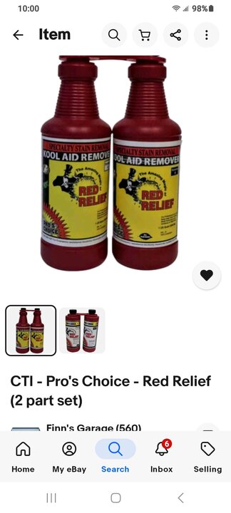

I would think that if all the cough medicine is removed. Then you're dealing with the red dyei personally would first colorfast test if ok them mist(thats mist, not spray,not saturate, MIST) hydrogen peroxide on it, lightly rub it in and cover with plastic wrap after dried see if any change, if lighter,repeat process till gone. If that doesn't work cti pros choice has red relief . A 2 part system that requires a steamer to activate
