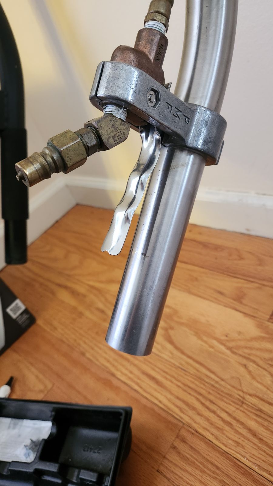

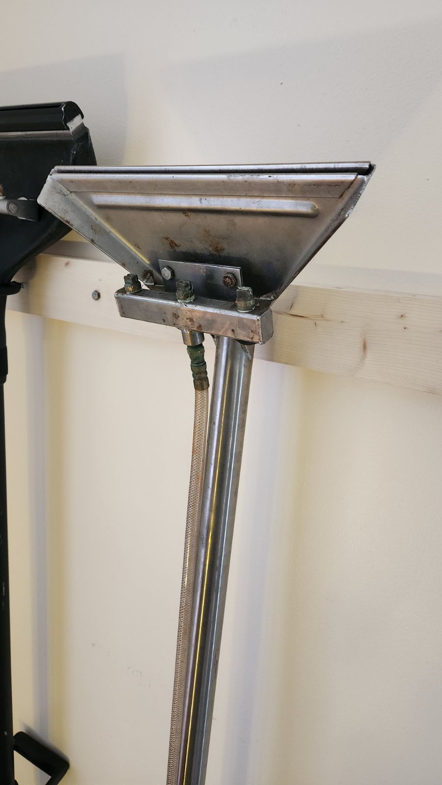

Hey yall!
I'm new to the forum. My wife and I just launched a carpet and upholstery cleaning business this past month. We love the work, the tools of the trade, the prospects, and this community seems pretty awesome. I've just been lurking here for a while learning as much as I can. Anyways I'm Bryce, it's great to be here :)
I have this PMF wand I'm wondering if I can get a glide for it. I'm not sure what model it is, can't see any marks aside from PMF on the valve. 3 jets and 12 inches wide. What do you guys think? I keep hearing about Green Glides something or other, are they like the world's most excellent glide or something?

Can you show me a picture of the front of the wand from head to toe?
I don't know who thought it would be good to put three Jets across the 12-in head, you're probably going to get a lot of overspray...

howdy Bryce
I realize you're fresh in the biz and I'm sure money is tight
but here's a thought you should consider.
by the looks of the supply line, looks to me that wand is only good for a low pressure portable.
Rather than spend $200 on a glide for it, spend $500* and buy a new wand from Mike that comes with a glide.
His wand will be infinitely better as well as being capable of hi-pressure portables and/or TM's when you upgrade down the road from now
*I'm "guessing" he can fit you in a new wand for about that much?

Howdy Dolly LLama and Mikey. Dolly, I bought it as a backup for my Hydramaster Evolution wand since it was fairly inexpensive on Marketplace. That's a good point it has a low pressure hose on it. It sort of looks like a makeshift thing that was done afterwards by the previous owner. It has 1/4" 8002 jets on it, are those more high pressure oriented? Good call about not investing in a glide for it if it's a totally inappropriate setup.
Mikey, I was thinking about getting some of the Wander's 1/8" v jets for it, do you think trying a narrower angled jet like a 65 on the outer jets might help dial it? Also if I use the same intersection the jets are on I think I'd have to use a fitting to adapt the 1/4" to 1/8" for the Wander jets and it would bring them a little closer to the floor. Here are the pics

PMF tools are a joke. I strongly suggest getting that very affordable westpak530 from mike. I've used several of the pmf and westpak wands and there is such a noticeable difference when you're on a tight budget and can't afford the Cadillac swivel wands or even the overpriced sapphire wands. Don't spend any more time messing with that outdated anchor.

I got an inappropriate low pressure wand setup and it's generally a pos. That's humbling Yea it makes sense for around $500 to do it right with the Westpak 530. Seems like a great deal considering how effective it is. I'll grab one of those at the Fest. Thanks guys!
