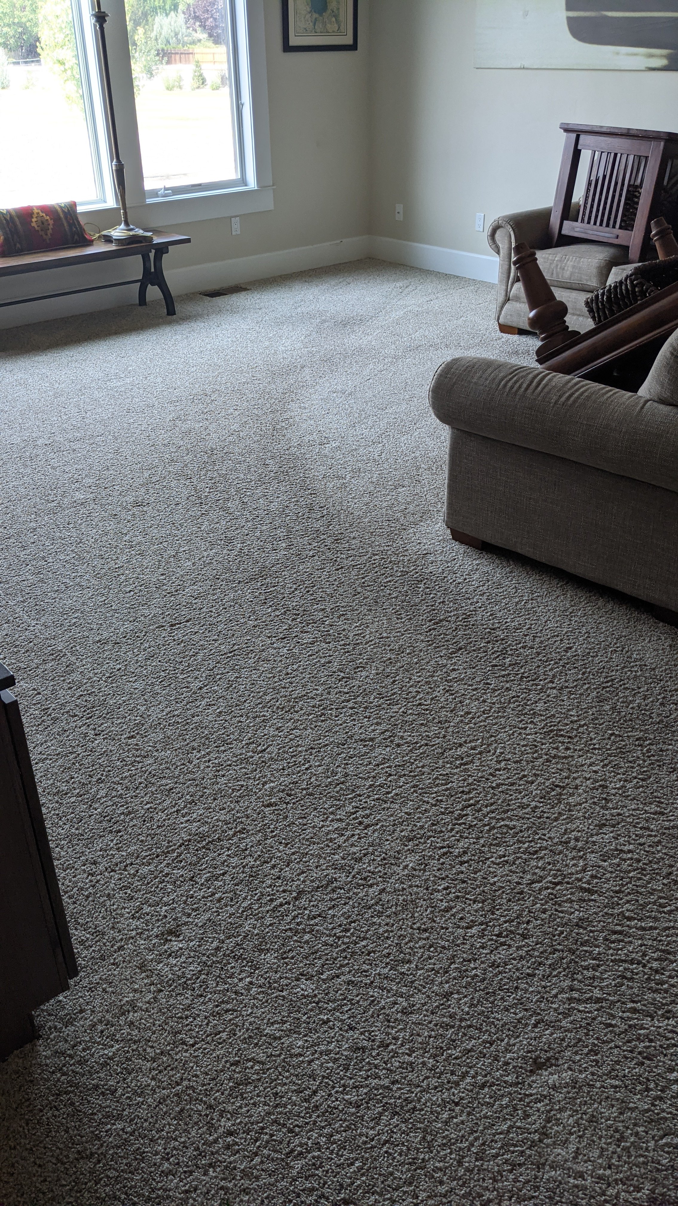

Looks like the last cleaner used a CRB on it
Foot shuffler..
This house belongs to the guy who built mine and I'm the only one that's ever clean that carpet three or four times now the master closet is twice as bad
he's a big old boy that doesn't pick up his feet..
Who's lovely and talented wife has great taste and design that she has a pension for picking shit that just doesn't work out well.
They build homes all over the valley and I can't count how many times I've had to go out and fix things carpet or tile related, granted a lot of them are installer mistakes..
I'm quoting her with the but it's this or that big name and it was their top of the line and slowly but surely she's starting the grasp when I've been telling her about top of the line can be crap too she's read our article on Porcelain and now she's very leery of putting it in homes that she seen some failures as well.
Seems like nowadays only carpet that holds up are super dense velvets
117,280
It causes them
I think you’re confused
they can, for sure.
Corn rowing appears most commonly on carpets made from fine, soft yarns, with a fairly high cut pile. In most cases the overall density is not adequate to support the yarns and keep them upright. If there is too much space between the rows, the tufts may be bent over when they are walked on. Soft, fine yarns do not spring back as readily as other carpet yarns made from heavier and denser fibers.
Corn rowing may appear on carpet before or after cleaning. It usually forms in a regular pattern with every fourth or fifth row of yarns bending over, as might happen in a field of corn. The condition may develop in traffic lanes and under doors that scrape the carpet as they are opened and closed. It generally occurs perpendicular to the traffic direction.
Although cleaning the carpet may make corn rowing apparent, it is not the cause of the distorted pile surface. Corn rowing is simply an inherent characteristic of certain carpet constructions. Vacuuming and raking the carpet perpendicular to the traffic patterns may help in some cases. In extreme situations, we suggest you contact the manufacturer.

It causes them
Crb can corn row more notably if you use to stiff brush. Use med or soft and always keep moving. Corn row will be noticeable when using it in its direction, change direction instead. That helps.
28,273
I find a pile lifter helps to improve cornrowing and matting in general. Don't use it often enough but I should.
