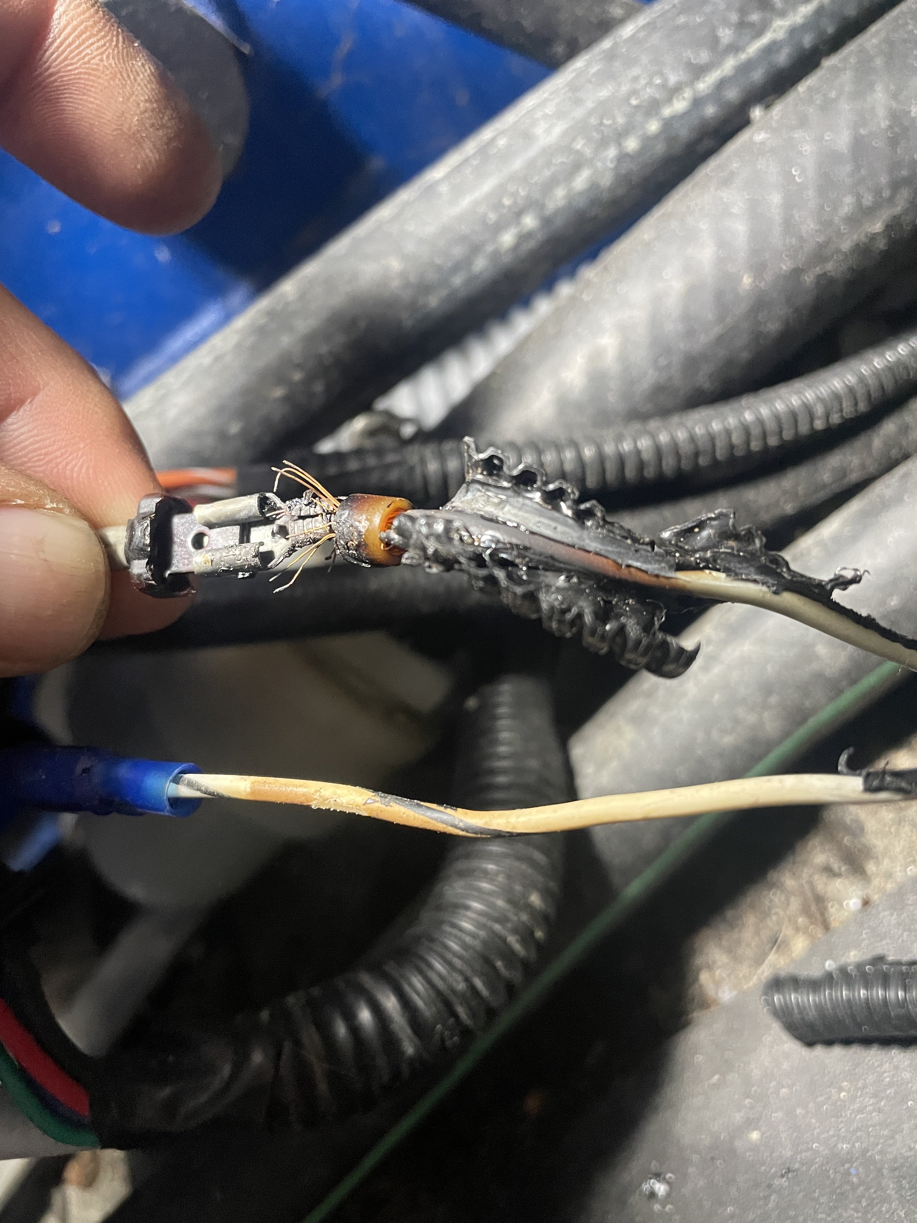

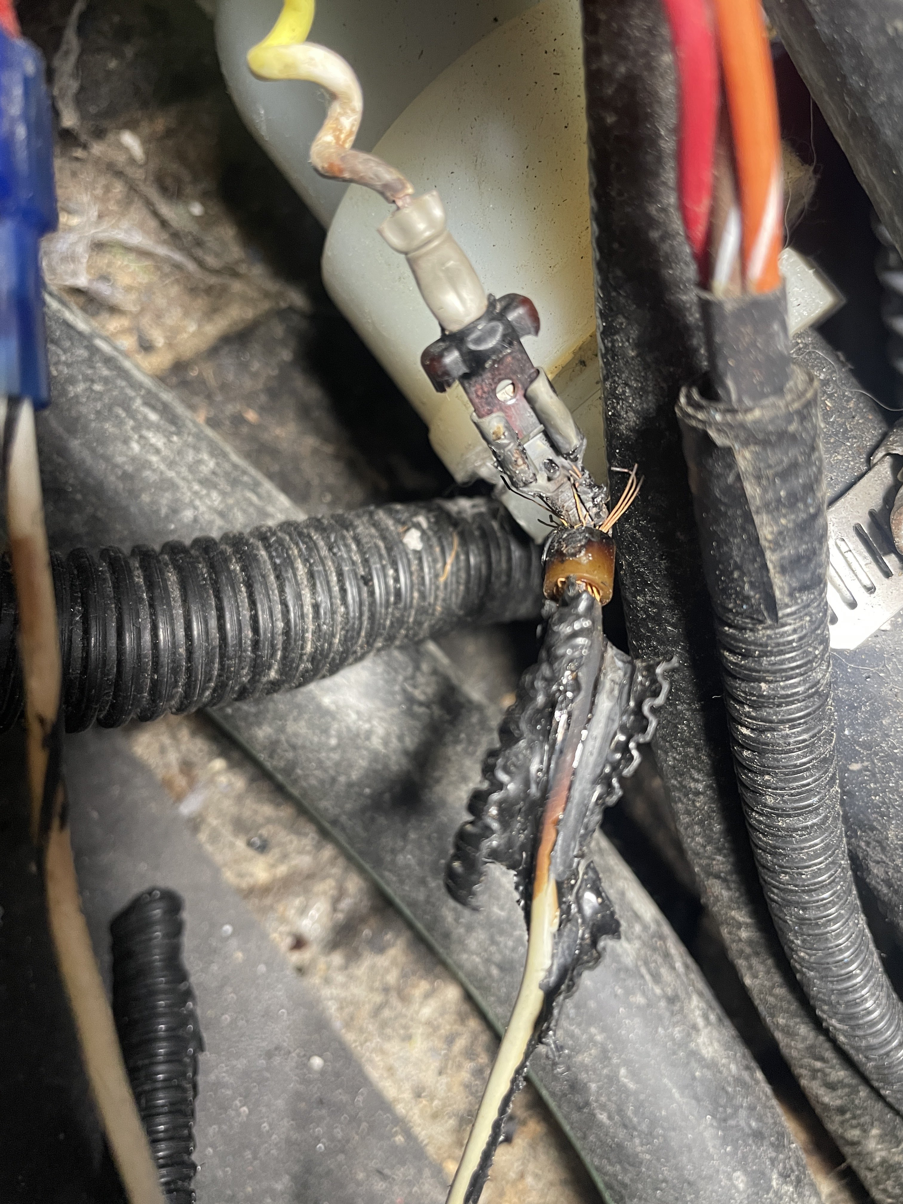

My water transfer pump from pond to waterbox on my rigs, get this way after a while. I notice the switch is getting a little crusty too. The transfer pump is constantly running and bypassing when not being demanded.
Is this common?
The wires look a little frayed because it broke when I took the pic so I just have them shoved in there sloppy. It had a clean connection just burnt and the plastic brittle and broken off on connectors.

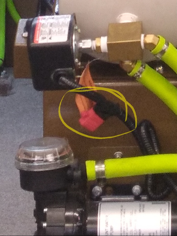

If possible, go to delphi weather pack connector, you'll either have to buy the tool to properly install um or your local dealer should be able to do it or you could use a butt splice and solder, then double srink wrap. Personally I like the delphi connector better but i have the tool. Also if you have a multimeter that reads amps i would check the load first and make sure the circuit isn't overloaded or shorted somewhere

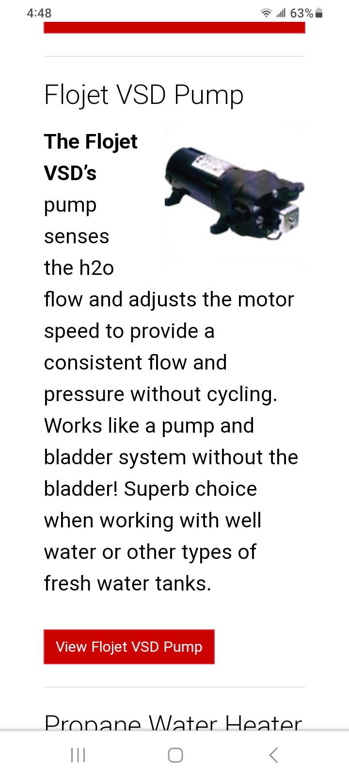

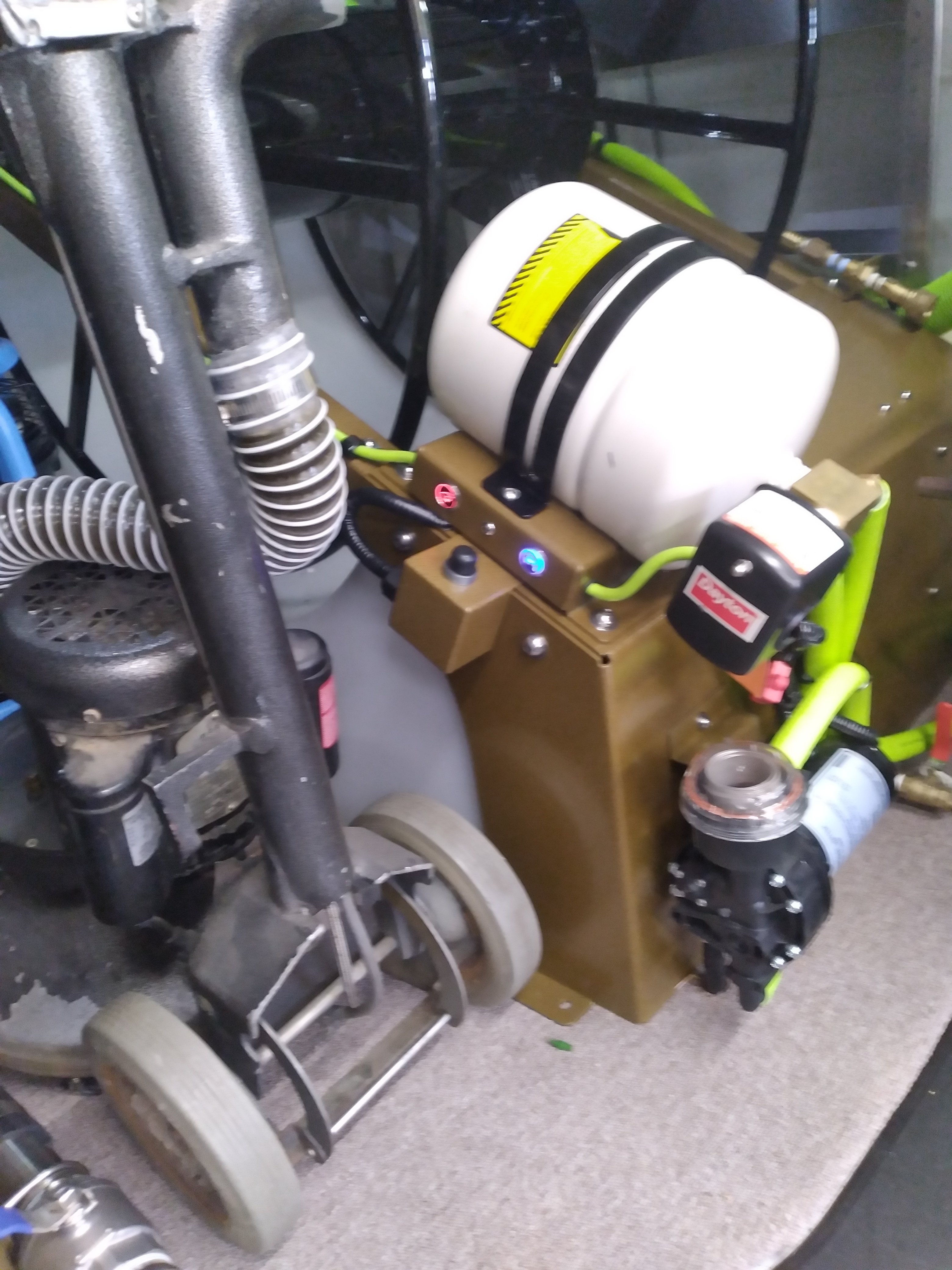

Ya the bypass didn't make much sense to me, seeing that most all these pumps are positive displacement diaphragm, how is it bypassing? And to where?, if this is a true prochem (sapphire scientific) waterpond it has a commercial Dayton pressure switch on the bladder tank i think the hydramaster does also, unless you have one of these flojet VSD pumps i don't know much about them but if you're controling the motor speed to controll pressure good luck, there's a whole bunch of other things there to go wrong and overload. Do you have a separate fuse in the system???

I fixed my connections by bypassing them. I just ran a homerun from the swith to the pump, less than 2 feet. The factory run of the electric to the pump is at least 10 feet and not a homerun.
(this also took care of the old connection to the switch). Now the pump is getting way better voltage, the wires should not be as hot. And just the hot wire was the one I replaced (to the red wire on pump, and confirmed with meter). It was barely getting 9 volts with the old wire.

Sound like you got a handle on it. Resistance = heat for sure. If the ground wire is that long it wouldn't hurt to shorten it also
