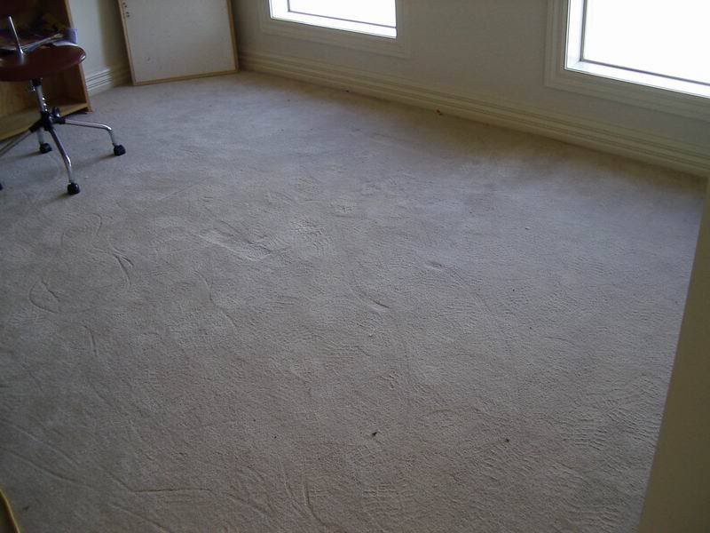

Steve, at a guess, cropping?
I have the occasion to do some of these, and often get very good results.
This one was colour that leached out of a piece of dark felt. It's over between the windows
After cropping
Bit closer
This was a newly constructed house, roof leaked in a severe storm, carpet was restored but this mark remained.
Builder was up for the entire house replacement because of this mark.
It's the fastest I've ever been paid by a builder :shock: :lol:
