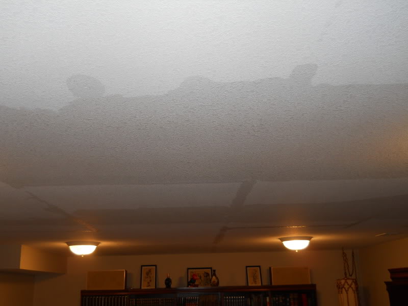

How many times have you seen a light fixture full of steaming hot water? It's crazy when it happens but on multi-floor losses it's pretty common. This is one from a loss we had today, elderly lady forgot and left the faucet running in the master bath. It wet the bath, the bedroom and hall and part of the living room on the main level. the went down though the HVAC vents and ceiling and flooded a family room, hall and bedroom as well as unfinished concrete area.

I always freak out when I see that, especially when the water is flowing OUT of the fixtures. I have this great fear of getting shocked, or a fire starting.

Richard, how do you handle water in fixtures like that, do you require an electrician to check everything?
Chris, we just do mitigation no reconstruction, we do pass that info on to the reconstruction company handling the job.
My guess is they replace the fixture. ?? I would if it were sitting long enough to get all crusty with mineral deposits and or debris.
If was just slightly wet, we would drop it down from the ceiling and make sure it was dried and I'd have no problem with it.
So really no hard and fast rule, depends mostly on time and the amount of water that flowed though it. In this case we know it sat at least two days, she was waiting for her adjuster to come out, they said get two estimates, once we saw it we suggested we get on it but she didn't want us there that evening or into the night. We returned the following day. The delay of two days cost the carpet and bleeding of some rugs on the main floor.
The tape had broke in the ceiling drywall and so we cut down the main section and dried the cavity and subfloor. My guess is they will pull the whole ceiling. Construction company's when slow, just replace far more than they should. : (
