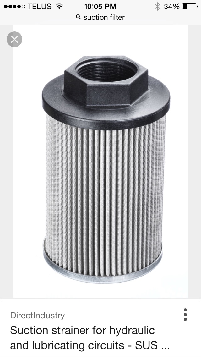

No. Filters are sized to not reduce airflow, yet protect the blower from particles that would damage it.
Are you sure?...... EVERYTHING in this industry is borrowed from somewhere else.....

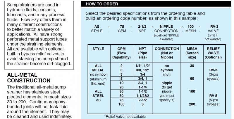

Flow Ezy's are originally designed for hydraulic fluid as well, I believe:
Note that all the Flow Ezy filters are rated in gpm, not cfm...
Like I said, hydraulic filter.... Sorry 'sump strainer'..... Well, I guess the old machine I ran for 4 years is going to blow up.... I took the old filter in to hydraulics store, and he MATCHED the #'s.... I took it back to my shop, and ran it for 4 years.....

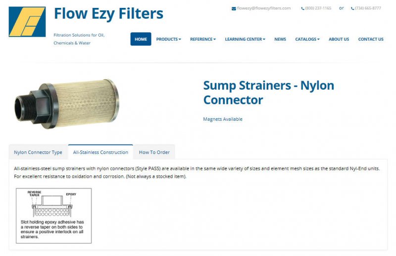

I prefer a nylon connector and SS filter material. I once had a strainer that had a nylon connector with SS mesh filter material but the interior support material was mild steel which rusted badly and fell apart.
