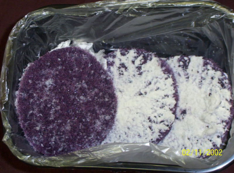

I have a box of the 3M SPP's. I've tried them on a really challenging old finish. I'm new with them so no expert at all, but they seemed less aggressive than the black 3m pads I'm used to. Seems like maybe you should be using a tank with the SPP???? They seem to gunk up pretty quick and lose effectiveness.

Yes you should use a solution tank on your scrubber. Adds weight, and allows you to keep the pad flushed.
Mixing SPP with strong strippers sort of defeats the purpose of both. SPP is, as the name says, a "surface preparation pad" to allow the floor to be quickly refinished without the "gunkiness" pictured above.
Just did a restaurant Sunday night that we do every 7 weeks. SPP made the job go MUCH faster, and with better results. No butyl stripper at all.
