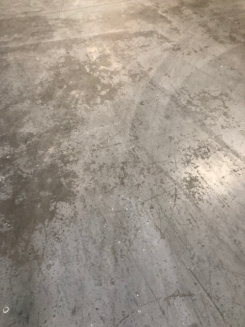

Best way to clean forklift tire marks on sealed concrete?

So my boss got a job cleaning a sealed concrete warehouse, we have never cleaned concrete before but we have cleaned other hard surfaces. So I was wondering whats the best way to clean off forklift tire marks, any help would be appreciated! Have picture attached for reference 20211027_170917.jpg

I remember reading about that problem on a pressure washing board once a few years back. There’s a product just for that, but I don’t remember what, or the techniques used. Look around FB for pressure washing groups.
10,204
True, but they still might not all come out. Some burn marks won’t. But that is the way.

your pic looks like it has failing paint, I dont think you be able to clean it, need to grind it off.

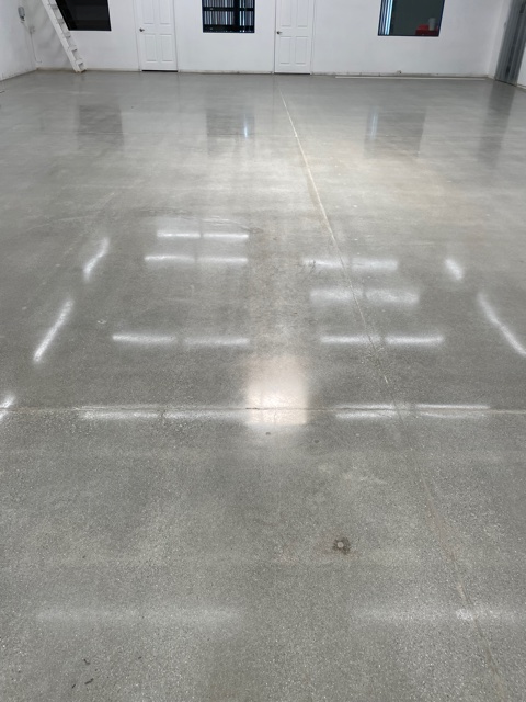

8000 sf building it was with failing epoxy, ground off start 16, 40, 80 metals, 100 transitional, 100 resins, denify, 200 -1500 guard and burnish
