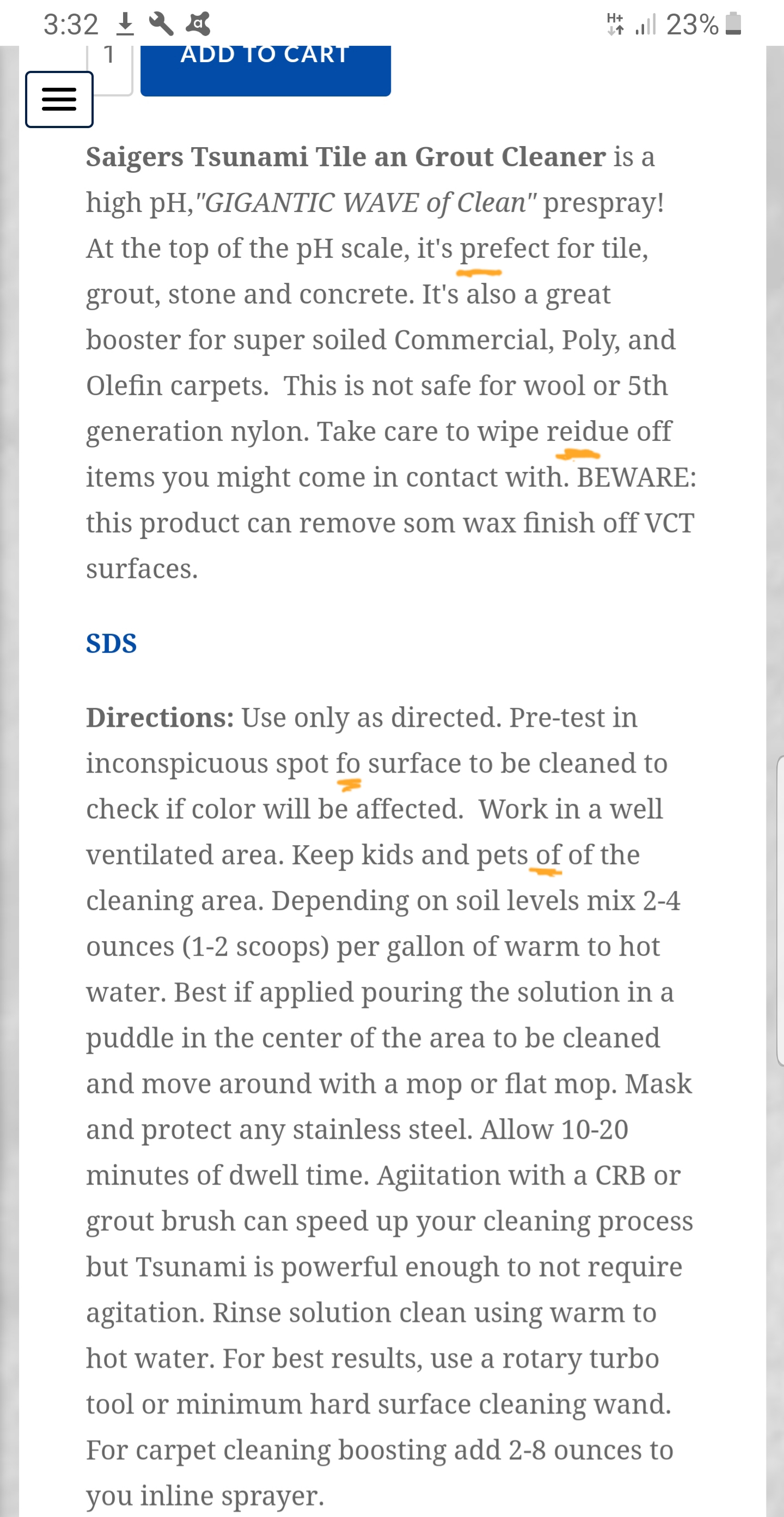

On my military vinyl jobs.. I use a hydraforce to spray down the same stuff I use on the carpet down the middle of the room then I use a mop to spread it out.
Since I started adding a couple scoops of Sager tsunami to the mix I barely have to scrub them maybe a little pool brush action in front of the kitchen range

@Mark Saiger was l0okin at ur page
and decided to go school teacher on it šŸ˜‰
