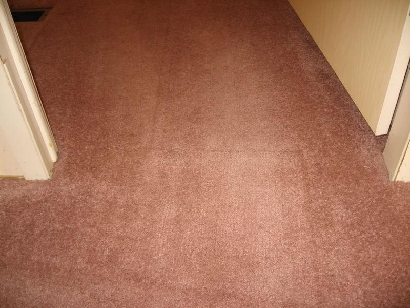

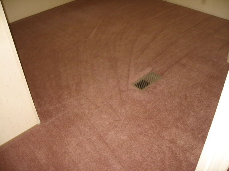

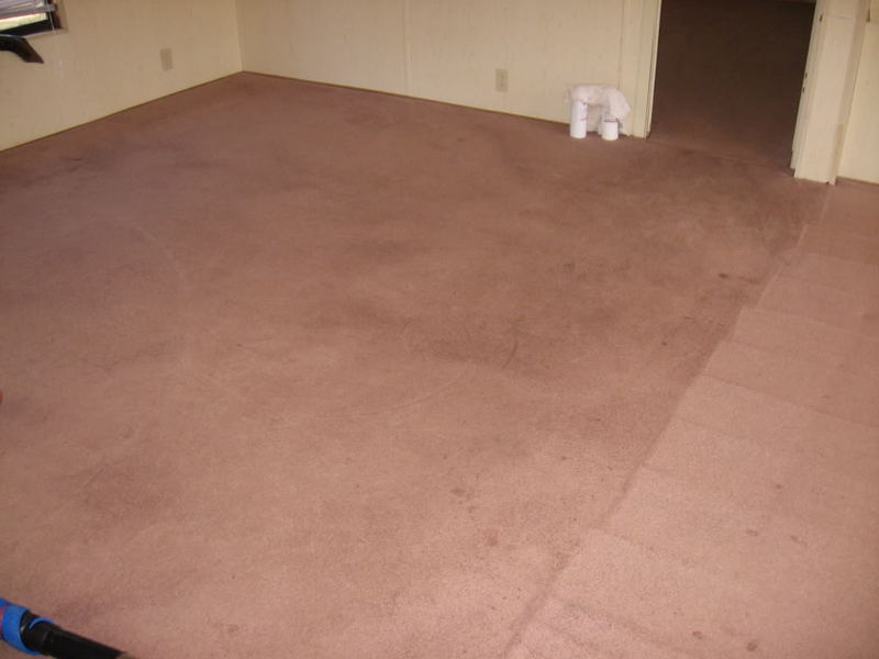

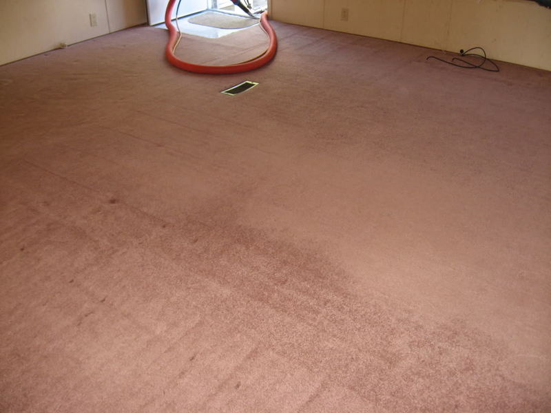

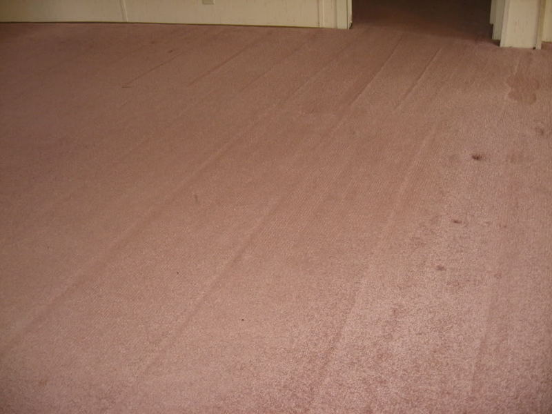

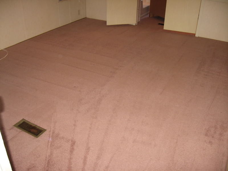

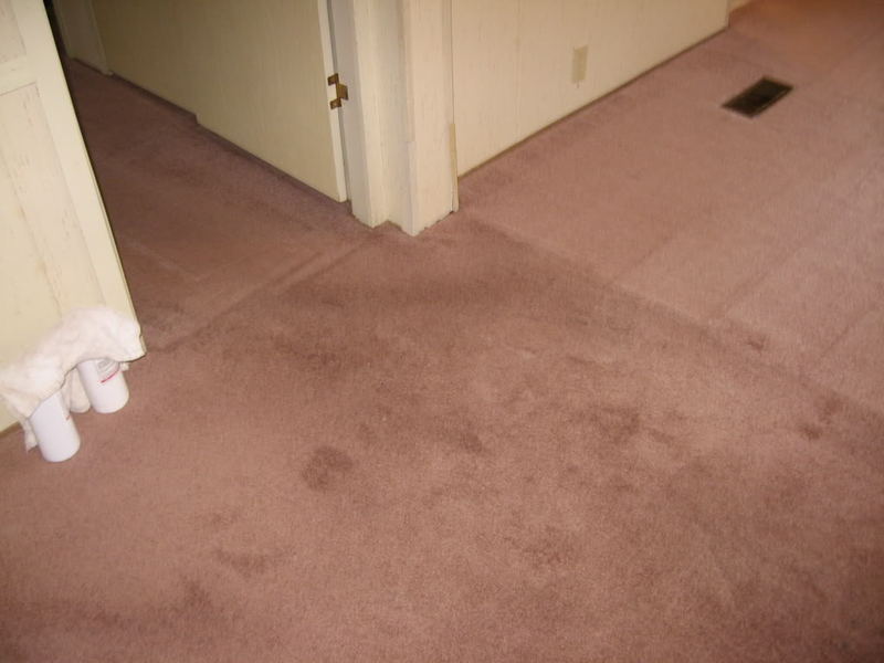

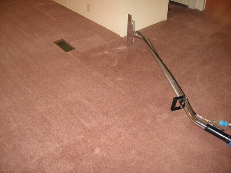

This is a rental of my in-laws so it was a non paying job. Anyways here's some before and afters. I'd say it was a light to moderate soil job. So it got PS, dwell and rinse. There is a lot of wear on it for sure.
The following 2 show traffic lane grey
view from other side of previous pic and it's also an after of the 5th pic.
Here is the 1 arm greenhorn in action for Bawb

Does that wand have jet extenders? I'm guessing no because of all the vapor.
If it does, I need more heat.

Yeah it's a greenhorn it comes standard with the extenders. I'm running 10 flow. The reason it steamed so much was because it was around 60 degrees in the place. There was no heat run last night in it and it was down to like 45 i think last night. It was around 11:00 when I did that or so I can't remember.
But I layed the wand down and took most of those pictures and started the video. I'd say atm it was 230-250 somewhere in that ball park cause it was sitting a few minutes. I run a cds 4.8 with the blower exchanger. I was running 100 ft of the parker themoplastic hose, also at 500 psi. It did steam all the time mostly cause it was cold. Most residential I get a little bit of steam though, my tm keeps 210-220 ish in the winter and a bit warmer in the summer. Although on cgd jobs it steams like that all the time if not worse at times.

oops. Missed that in the pic. :oops: That thing was steaming like a mother.
I'd really like to have another 20 degrees. That's my only complaint with my Boxxer 421 right now.

would it be the extra bit of heat or just needing an angel adjustment on the jets?
I was cleaning a restaurant today, greenhorn with hybrid glide, 15flow, 700psi, my temp guage is TU so its hard to telll, at least 200+, and I was watching the steam and thinking of the hydrosonic wand, how it didn't show much steam. Mine was sucking the steam right back, sure didn't kick out like in the vid.
Last time I had steam like that was with my old wand. Makes it hard to see what I am doing.
North East Ohio
all things being equal, atmospheric conditions (temp humidity) will make more or less steam at times

Exactly. While Tims CDS does have some surprising heat for a Clutch drive it is not hard to get steam down hear in a 45 degree room. Typically the air is so full of moisture it just seems to have no where else to go. So the steam looks like smoke and just floats around. On really unusual days when the humidity is low the vapor seems to be absorbed by the air. No scientific evidence just observations.

Yeah like I said I usually don't get that much steam on residential. And that was more than I was getting when going for a long while on that job. Like I said the heat probably was spiked some due to the wand sitting getting the blower exchanger heated up, the jets were dripping a little durring that video so that says something. But it was fairly cold in the place, I was able to wear shorts but I don't mind the cold like some. Like I said I think it was around 60 degrees in the home it was colder than outside than inside the place. But on CGD I get a good bit of steam. Also 20 degrees does make a difference in steam cause I do get steam in regular homes once the blower gets hot just not as much as you saw in the video. And get this....I want more heat. :twisted:
