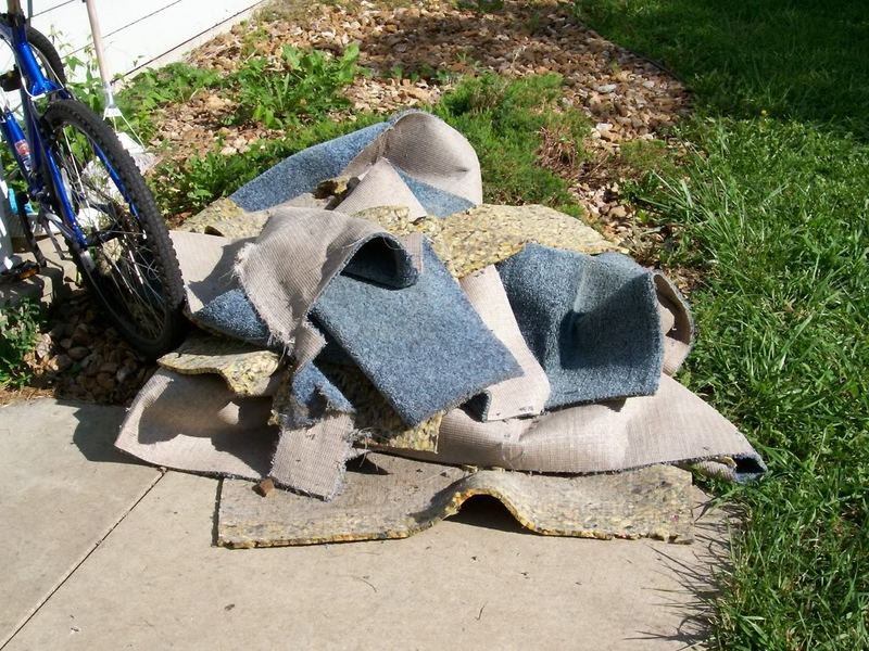

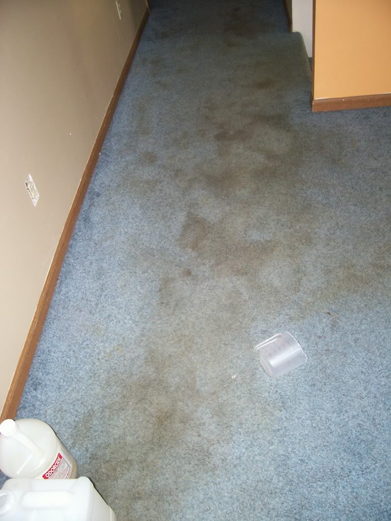

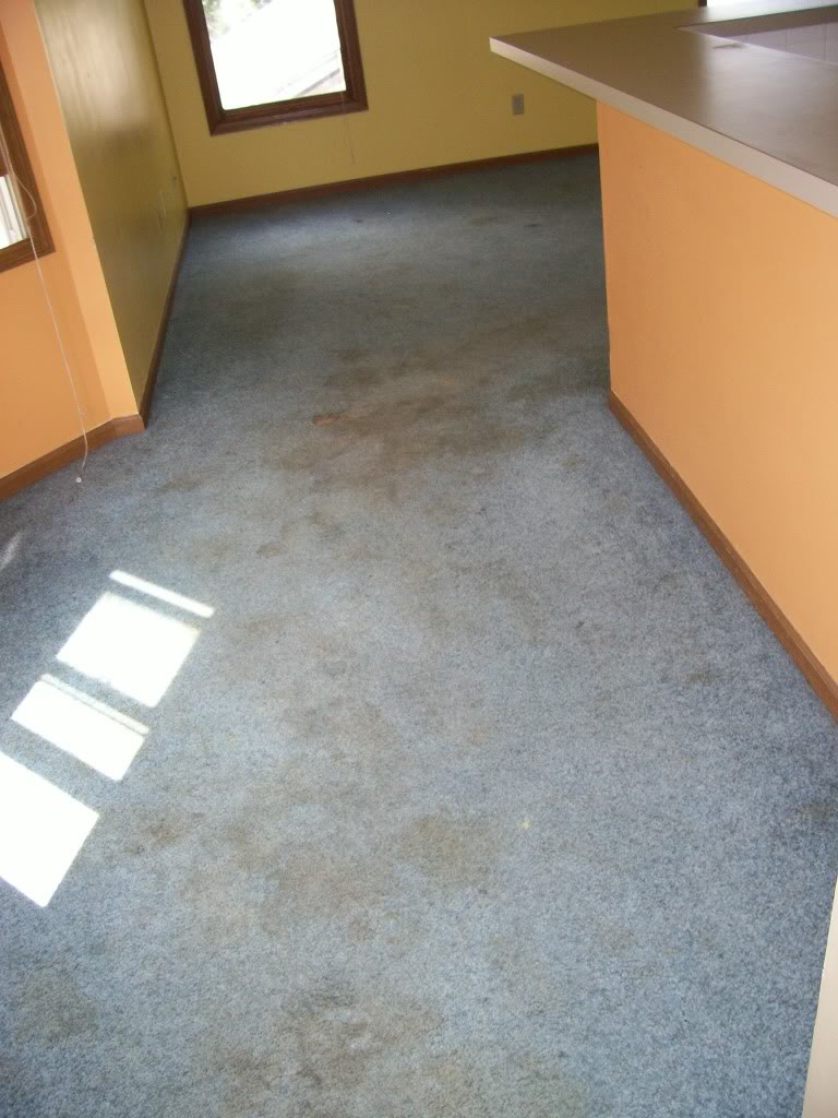

The landlord said he needs this done fast because someone is moving in the same day. He says the main thing is odor. I explain that with the sub-surface extraction method (OSR), I can usually remove urine odor 100%. I told him that I due the extent of the damage sub-surface extraction would not be practical. I tenets had dog(s) cat(s) and a ferret. I told him I would treat the surface for odor but It would only do so much. I sprayed down 4 RTU gallons of odorcide, used an enzyme pre-spray, scrubbed with CRB and extracted. I come back a few hours later to do another unit and the carpet was on the curb. I really need to learn when to walk from jobs.

Knowing when to walk comes with experience and confidence.

Personally, i would of recommended replacement from the get go on a toxic rag like that
I'm curious why you say,
" I really need to learn when to walk from jobs."
why?
you were straight up with the guy
(though I don't believe for a minute you'd of got "100%" of the cesspool w/OSR and claw)
Never the less, you explained the options and he made the choice, right?
AND you charged for the treatment, right?
AND got paid, right?
what am i missing?
don't worry..be happy...Deposit the check

On those types my hydrasensor is used as a cane for the blind. If I walk more than 10ft at each doorway with constant beeps I run.
Had a rental a few weeks back with old ferret probs. It was everywhere, recommended replacement and I get cussed. Well sir get the phone book someone else will come out and take your money. Renters where complaning about the odor from the past tennant.
I have a few landlords that we should drop. Most I can save just not that profitable.
