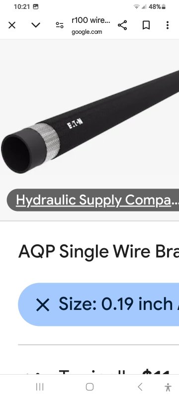

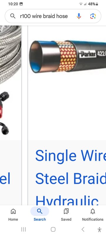

NO NO NO!!! You clearly do not know how these hoses are built . Black death is the rubber inner hose degrading generally from chemicals the wire braid has nothing to do with it . Here is a picture on how a 100r (single steel braid hose) is built
View attachment 130345 View attachment 130346
The thermal plastic hose is constructed the same but with differant materials for instance regular hose outside blue cover rubber other hose plastic. Regular hose inner refocusing braid steel, other hose fiber. Regular inner hose(soulition carring) black rubber other hose possibly teflon (i really don't know) but both hoses are constructed the same they just use differant materials in the construction.
