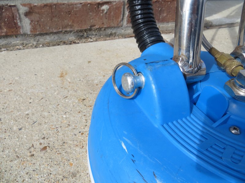

I have 400 sqft of travertine that is really dirty and has not been cleaned in 5 years.
I run butler equipment and use a turbo tile tool
Describe your best way of cleaning it
Thanks!!

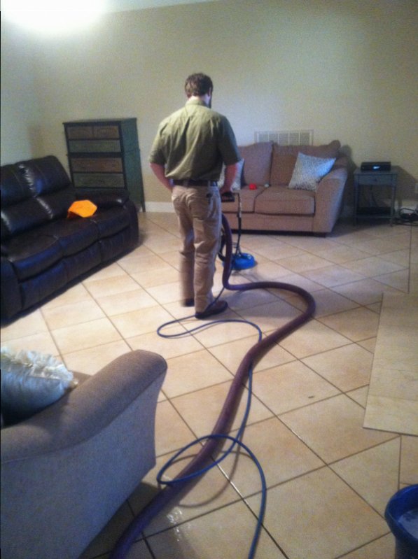

Powders, Diamonds, cleaning, sealing.
I quickly took Rob's advice that it is a 2 person job. I don't have employees. (I like it that way)
So I sub, Friends (competitor's) that I trust. View attachment 1284View attachment 1286View attachment 1285
The GentleMan in that Pic, is Lou Waterfall, Kemp's Dad. He came out to Phoenix to check out this "Stone work" He took home a lot less fear of natural stone.

Hi Dave,
You have a few options depending on your desired outcome.
First, because of the equipment and tools you have cleaning will be simple, fast and with very little ton no elbow grease. Pretreat the travertine with a good high alkaline natural stone cleaner. Stone Pro's Deep Clean Gel for example. Let it dwell for 5 to 7 minutes then let your spinner do the rest. Your water temp should be 200 degrees. Start at 200 to 300 PSI and work up from there. Travertine varies in density and the amount of unseen voids.
