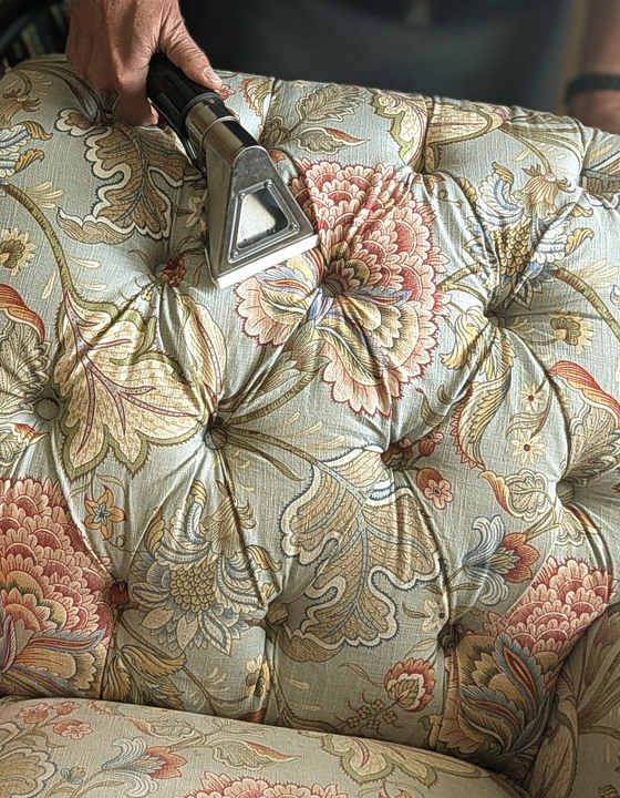

The GreenGlides JubiLee Upholstery Tool
The JubiLee is the result of years of field testing, designed to fill the gap left by the industry’s lost classics. Built for passionate cleaners who want total control—not a "one-size-fits-all" answer—it moves away from the restrictive approach of traditional low-moisture tools.
Key Selling Points
  • Heirloom Titanium Build: Constructed from high-grade titanium, making it 25% lighter than standard tools. It is virtually immune to corrosive chemicals and high-heat warping.
  • The "Misting" Philosophy: Why over-wet what isn't dirty? The JubiLee allows you to "mist" the 50% +/- of a typical sofa that rarely sees soil (backs and sides), drastically reducing water usage and dry times.
  • Optimized Heat Retention: Equipped with a 9502 jet as standard. This specific flow rate is enough to "trigger" your truckmount’s heat exchanger or fuel-fired units into carpet-cleaning mode for consistent heat.
  • Industry-First Overspray Chamber: Featuring four evacuation ports inside the spray chamber to capture overspray or excess solution instead of the water ending up on the floor or your pants—a huge time saver.
  • Precision Pressure Control: Unlike other tools that "spit" if pushed, the JubiLee’s encased spray chamber allows you to run from a mist-like 50 PSI up to a high-flush 600 PSI (200 PSI recommended for most situations). The Jubilee does not leave lines or distort certain fabrics—another huge time saver!
  • Superior Ergonomics: Features a short-stroke head, a 1.25" high-flex hose, and a swivel placed right at the wrist cuff to eliminate the unnatural bend and fatigue common in longer style tools.
  • "Knuckle-Safe" Design: The 1,200 PSI valve and trigger are positioned to keep your hands clear of rough upholstery and the trigger lever away from the fabric.
Standard Inclusions: Comes with a 1.5" x 1.5" Hose connector with vacuum release, adjustable ball valve w/ micro knob to reduce PSI.
Includes shipping to the Lower 48! (Call or write for a quote elsewhere).
Glide Options & Customization
While the 9502 jet is the perfect "all-arounder," you can still customize your physical contact with the fabric with optional 9501 or 9503 Veejets:
  • Fine Fabric (Hole Glide): Maximum dry times for high-end fibers. (Requires thorough pre-vacuuming).
  • High-Soil (Slot Glide): Maximum debris recovery and flushing for greasy, heavily soiled synthetics.
Remote Heat & Water Management
For older or "odd duck" truckmounts that require high water movement to stay hot, we offer a standalone Hot Water Circulating System:
  • Heated-at-the-Tool: The system is located at the hose end, not in your hand, keeping the solution hot without adding weight.
  • Water Disposal Options: Send unused water to the waste tank, a sink, or outdoors.
  • Sustainability Setup: Run an internal 1/8" line back to your fresh tank to save water and chemistry. For the tidiest setup, this return line can run inside your vacuum hose.
Versatile Hose Lengths
Keep your connective cuffs and quick releases outside of high-end interiors to prevent scratches or drips:
  • Standard: 10 ft, 15 ft, or 20 ft.
  • Specialty: 6 ft for portable spotters; 35 ft or 45 ft for aviation and high-end RV detailing.
  • Custom: Call for a quote on any specialized length.
Operator Pro-Tips
  • Detailing Without the Glide: Removing the glide exposes the full 6mm opening, phenomenal for detailing carpeted staircases where a standard wand won't fit. Use extreme care to not scratch delicate wood or metal trim with the exposed framework.
  • Glide Removal & Fitment: Always grab from the front of the head when removing. Because these are hand-welded, you can use a razor to shave a "hair" of Teflon off the end plugs if the fit is too tight—but go slow, as we cannot replace glides due to operator error!
  • Break-In Period: Like a carpet glide, the Teflon will burnish and "wear in" over the first few jobs, becoming smoother and easier to remove/replace with use.
  • Protect Your Investment: Avoid contact with tack strip nails or transition strips that can gouge the glide or the tool head.
