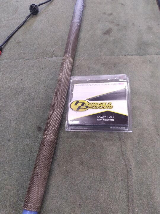

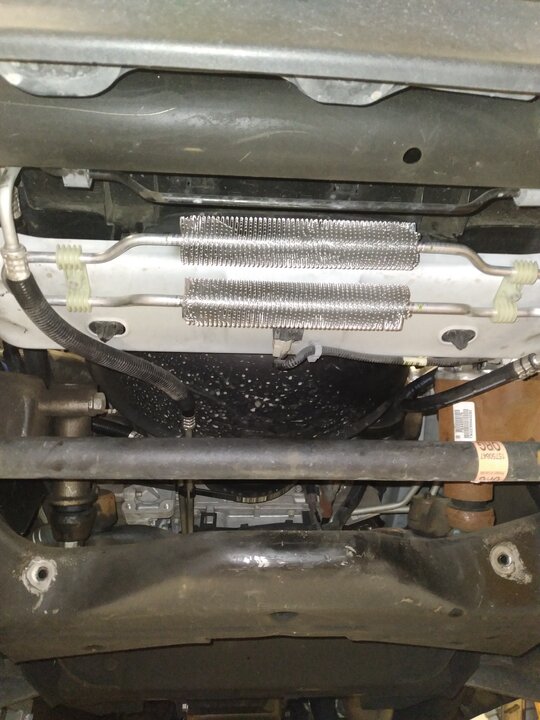

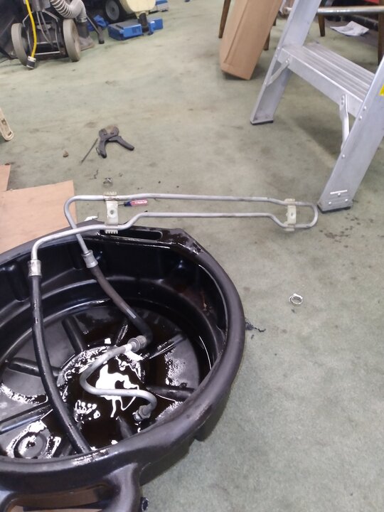

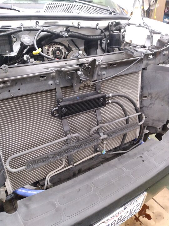

When i started buying steamgeni ptos, over a period of 13 years i bought an intire fleet of 8 from a company in Sacramento California where the temperature reaches 110° in the summer. All the units had similar issues all could be traced back to heat and poor and/or lack of maintenance. What has to be understood and addressed is the fact that when running a pto, the engine is running at about the same rpms as it would be doing at 35 or 40mph without the 35or 40 mph air flow running thru the engine compartment. Most all the heat related issues could have and can be avoided. When i built Frankinstien i addressed the heat issues during the built, simply and fairly inexpensively. #1 i switched plug wires to extreme temp silicone plug wires then added wire insulation covers. #2 added extreme 25,000lb towing rated transmission auxiliary cooler. This cooler was put in series with existing radiator and factory heavy-duty coolers. Fluid first cools with radiator cooler then factory heavy-duty then extreme duty cooler #3 removed the pipe loop power steering cooler pos and replaced it with a gm extreme duty finned power steering cooler then added a second fin and tube power steering cooler in series. #4 Covered and wrapped with wiring heat wrap and hose insulation all wires and hoses that could be exposed to high heat. The result is a van that can stand up to running in high temperatures without alot of the problems associated with it year after year. Of course where i live temperature is not a problem my machine rarely operates above 75° but the steps ive taken in the initial build i consider very cheap insurance total cost was approximately 300.00 transmission 225.00 power steering 200.00 spark plugs and 175.00 miscellaneous so around total around 900.00 cheap insurance against heat related breakdowns. you're only as good as your tool !
