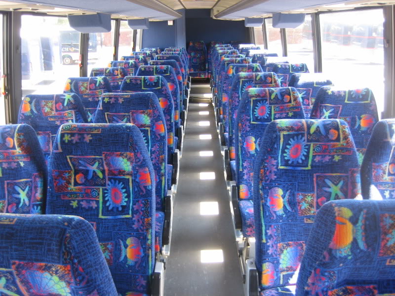

20 buses with 50 seats each.... how much?
117,375
I've never done something like this.
How long would it take two of us to bang out each but with the V?
Vacuum pre spray and Prochem uph tool rinse?

$2k or so... It'll take an hour per man per bus or so. Prespray a row then move hoses. Like a movie theater.

3-5 mins per seat, if you are indeed vac, prespray and rinsing. A little over an hour per bus, dual wanding and or 1 person cleaning, the other prespraying, and wiping things down, and hitting those head rests after extraction with a towel.

I tried bidding some at $250 per, didn't get 'um. I had no idea how long it would take either, an hour for two guys seems pretty quick.
K
Ken Snow
$2-3 per bus and a little over an hour per seems right so if dual wanding you should be able to make about $200-300 an hour for the 2man crew and V.
Steven and Ken have it. 3-5 minutes to do them and $5.00-$6.00 a seat.

That's a job for Xerion if I ever saw one.
Way faster, way easier set up. Just as good or better appearance.
Are they requiring HWE or did you decide on that method?

If I was an unethical cleaner I'd be tempted to leave the V idling with hoses tucked in the buses while I ran my right angle grinders and Xerion.
Any chance you can tell them that in your professional opinion you recommend a different method for this job....especially if you let him know you can do it quicker and less expensively (and quieter) and have it look just as good?

You may want to check fabric to see if it is wool. Wool is used often for durability and fire resistancy.

thats worth at least 250/bus
think of the work you would put into a sofa and what you would charge for that, ESP if you're going to prevac.
With your V you could clean two buses at the same time.

I would run 2 - 2 man crews each runnig off a 2.5 hose with a splitter floor guy goes in and presprays with snake oil and scrubbs the headreast. Second guy starts rinseing with snake oil In rinse. Floor guy starts rinseing As chair guy wraps up chairs and starts applying protectant. Crack open windows and place a blower.
Cost per bus 280 + 95 for protection. 1 hour 15 min max per bus.
If you need them I have 2 prochem uph tools.

Where are you geniuses buying your calculators? At 2 minutes per seat it's over 1.5 hours. At 3 minutes per seat it's 2.5 hours. If you think you can blow through these at a minute each, you're crazy. These seats will be filthy all over and will have to be thoroughly cleaned.

I did some buses eaelier in my life and you would definitely have to prevac. They will be loaded with dust and dirt.

Mike.....wit your big arse, it would be tough moving around those seats. Those 2-3 minute a seat times would surely turn into 4-5-6 minutes as you run into stains, and vaccing the excess water from the overspray on the floor. I would say at least 3 hours a bus, single tool. I will have a school chair job coming up in December....maybe 350 chairs. I did them last year, and planned on flying through them until we ran across stains and dust. I did buy another PC upholstery tool to help out with the chairs last year. That helped ALOT!
And your wrist and arm gets real tired after a few hundred seats. But I forgot....I'm dealing with young pups here, not 56 year old cleaners. I can work all day, but it gets a little wearing after 5-6 hours of constant cleaning.
At least $300 a bus. Sounds like the local theaters......they want all their seats done for like....$1.00 a piece! Dark, nasty, stanky locations!
