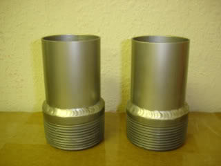

Those 47 class butlers have 3" elbows on the waste tank, and Butler uses a bushing to reduce them to 2.5", and a 2.5" plastic combo nipple (barb) for hooking up the 2.5 hose.
Recently we made a more streamlined 2.5" thin walled combo nipple, I think I will use this in the future to replace ALL plastic 2.5" pieces.
pic:
also the 2.5 dual elbow for the old vortex

Those are some really cool inlets, built well, and install easily. The Genesis elbows are simular, if not the same. They contribute most of the improvement on the Genesis air flow, in addition to the 2.5 hose. If you want to use just 2" hose, the cuffs slide right into the elbows.

I think I'm gonna want 2 of those 2.5 nipples in a while.....I just hate to know how much they cost though. Not saying they aren't worth it or anything.

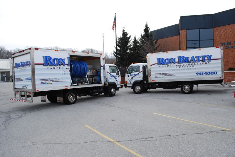

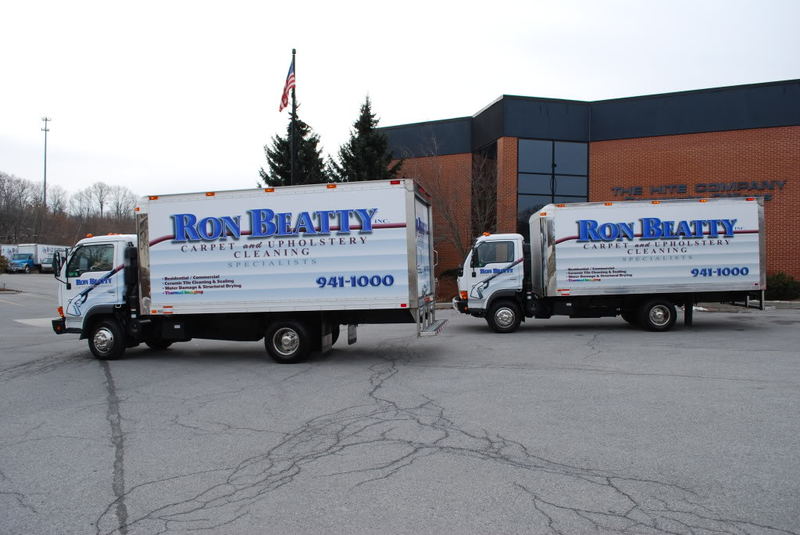

Ron, I was a Butler customer for 25 years and probably was involved in the purchase of at least 13 brand new Butler units. In 2006 I had Butler custom build me a GMC cube truck with custom shelving, 200 gallon waste tank, and 200 gallon fresh water tank. The one request that I made was that they would make the hose reel larger. Butler said they would not do that. After the truck was delivered, I took it to the local truck scale to have it weighed and found out that when the clean water tank was half full and the waste tank was empty, the truck was over weight on the front axle. Their response was to tell me to install Timbren ride supports in the front suspension, and one airbag on the drivers side in the back to level the truck as it leaned to the left :roll: . The reason I am telling you this, is that you need to look for a supplier that is more interested in what you need, then what they want to sell you. I called Butler on Monday to order some parts and was told that they would no longer sell me parts because they are mad that I didn't buy their equipment. (Does this sound like 7th grade girls or what!). Last year I ordered a new Vortex and was very pleased with Blueline's interest in customizing our truck to meet my needs. Because they where so helpful, I sold my second Butler and bought another Vortex. We have equipped these trucks with power solution reels and many other improvements. They will be at Pemberton's for Winterfest in January if you would like to see something designed for carpet cleaning by a carpet cleaner.

Mark, I thru my swivel coolcuffs for 2.5 away. they kept breaking apart when I would reel the hose up on the small diameter reel. Greenies cuffs worked better for me. And Ron B, I look forward to seeing your trucks at Pemberton's winterfest. It should be a good time. Thanks, Ron

damn nice trucks Ron.
I see the patented Mikey bend restrictor on the lead hose. :wink:
